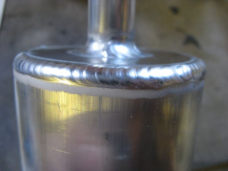

IS there anything else that affects the size of the cleaning zone apart from AC blance? I'm currently getting this:-
Using the following setting on clean 3mm aluminium
90A
AC balance 30 ( 70% DCEN ) I think!
120Hz
1.6mm 2% lanthanated tungsten
Welder is RTech TIG 201
Is there anything I can do to reduce it??
