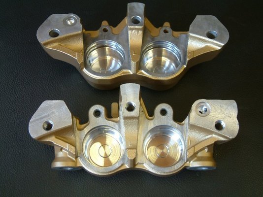

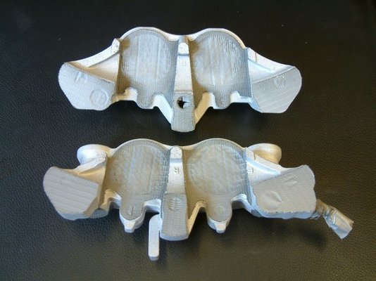

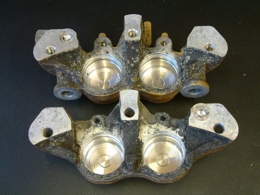

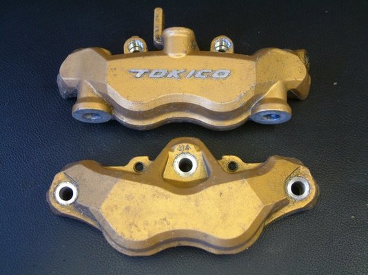

A mate asked me to blast & repaint a set of Tokico Radial Caliper from a Kawasaki.
Not too bad on the outside.
Not too good on the inside but I've seen much worse.
Gently cleaned with stainless steel wire brushes, masked and blasted with J Blast Superfine on a low pressure.
Ditto.
VHT gold spray paint, not quite a colour match but hopefully will darken a little once oven cured.
Ditto.
Will be baked at gas mark 6 tomorrow in his oven as he's a chef and I know what the smell will be like. (He doesn't yet!)
Ditto.
Ditto.
