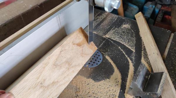

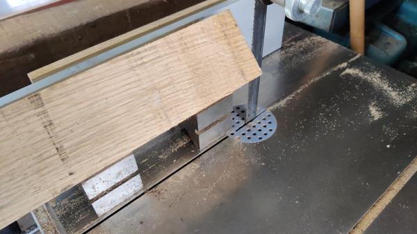

My bandsaw has a tilting table to allow cutting angles other than 90° to the table. However, I'm generally too lazy to muck about with the table angle, so I went with a different way of cutting the corners off. The angle isn't really critical and it doesn't matter if there's a lot of break-out at the end of the cut, so lazy methods are fine I think!
I start by grabbing a couple of fairly big v-blocks and plonking them down on the table:
It's fairly important that the bar having its corners removed is a lot bigger than the v-blocks, but I've got quite a few of different sizes, so that's easy enough. The bar gets mounted on the v-blocks and pushed up against the fence and then the first corner can be chopped off:
The second corner is done with the first chopped-off corner lying flat on the table...

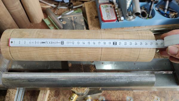

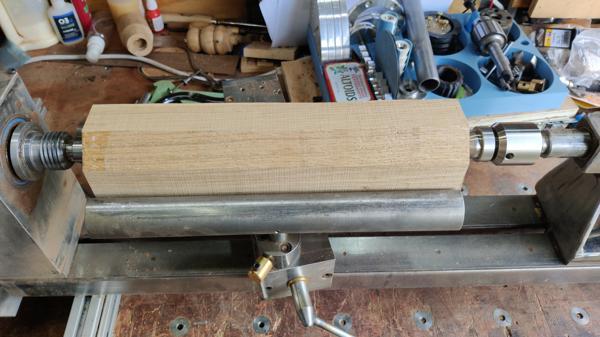

... and the last two corners are then straightforward. I could then cut the bars into 300 mm lengths and mount them (one at a time, obviously) between centres on the lathe:

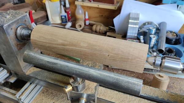

A roughing gouge was used to get them round-ish (this photo flatters the finish!):

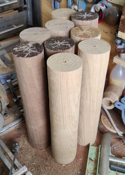

After lots of work covering myself in little bits of wood, I had quite a decent collection of oak and walnut cylinders:
It's probably worth noting that I'd already tried (and wrecked) three attempts at mills before making all these cylinders. The last of those three wasn't **quite** as bad as the other two: it vaguely looked like a pepper mill (rather than disintegrating on the lathe) and that gave me enough confidence to finalise what I wanted them to look like and then to start bulk production.

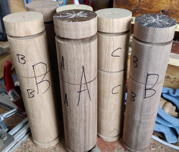

With all the cylinders made, I picked six of them (in the optimistic hope that I wouldn't mess any of them up) and, after remounting each one on the lathe, I drew three lines...

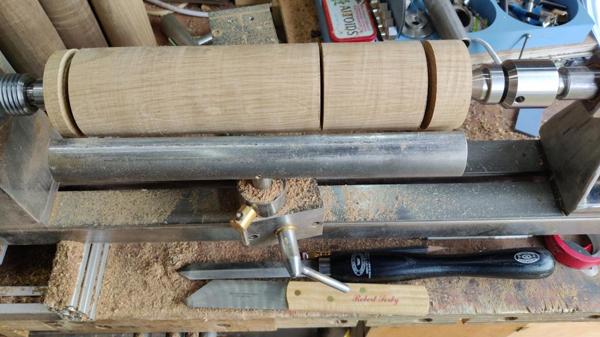

... and then used two different parting tools (seen at the bottom of the photo) to cut deep grooves on the lines:
I took the opportunity to label each of the blanks A, B or C so I wouldn't lose the pairing between base and lid:

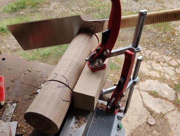

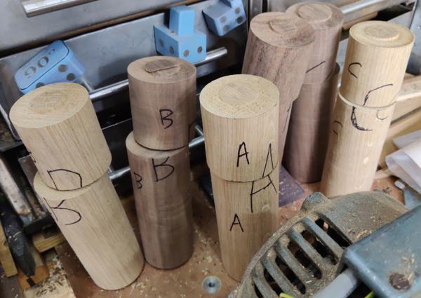

I needed to split the blanks into four pieces (of which two are scrap) but with the limited space in my workshop and the bench occupied by the woodturning lathe, the easiest way I could think of to split the blanks was to clamp a bit of scrap to the end of the lathe to act as a bench hook:
A little bit of sawing later and I had a set of blanks ready for turning:
