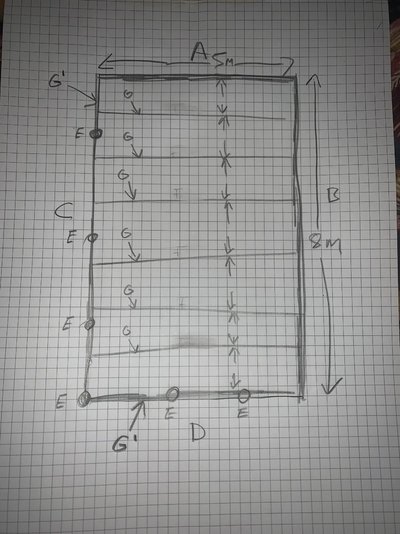

Hi, we live in Spain are at the planning stage of converting a warehouse into a house. I want to put in a mezzanine floor and was going to use timber, but I’m now thinking of using steel box section instead. The floor size will be 5 meters x 8 meters with the maximum span being 5 meters. It will be bolted and set in to the wall along two sides so support on these sides won’t be a problem. On the “free” end I can put in 3 or four supporting uprights to carry the leading edge of the floor. I’ve just done a quick sketch so hopefuly it makes more sence.. A + B will be set into the wall.. C + D will need support. So my questions are.. what size steel box section will I need for the beans marked G and G1 on my drawing and what spacing would I need between the beams.. also how many support beams (marked E) would I need for the size of the floor. And finally is it better to weld spacing beams between the bars marked G ? The floor above is going to be clad above in timber and the new mezzanine will be used as a bedroom at one end and an office at the other. I hope this makes sence ?? I’ve confused myself drawing the bloody thing..
) if me,A's and B's fixed into the walls(brick?),G's hung from B by hangers onto C,but the support for C is a main factor,are you running these up to ceiling height?
