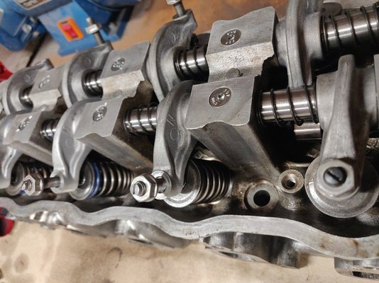

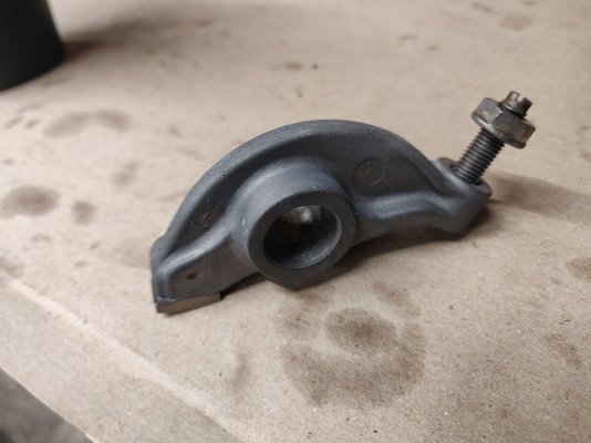

I have an aluminium valve rocker with damaged adjustment screw thread. It's an M7x1.0 thread, so I thought no problem, tap this out to M8x1.0 (same pitch so should work nicely) and fit some VW T1 / Beetle screws. That almost worked, the VW screws are the correct diameter and pitch but are 2 mm too short :/
Does anyone know of other cars that use M8x1 tappet screws?
