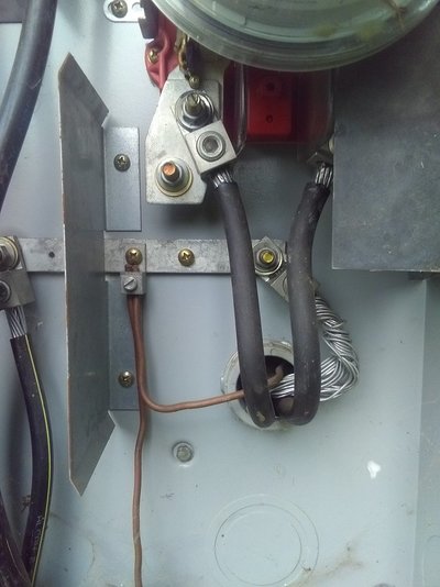

Someone posted about doing the same a few weeks ago, and this job popped up for me as well, so I thought I might as well document it.

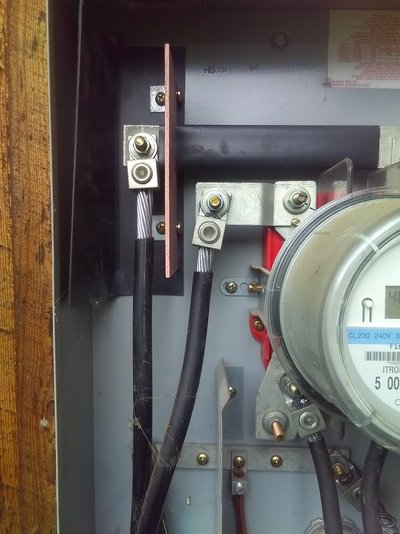

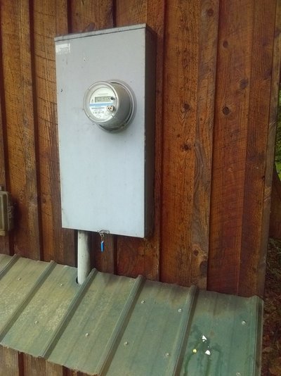

Years ago, when I put in the service to the shop, I installed a 400 amp meter box.
As single phase panels are normally only 200 amp, you use 2 of them side by side.
This is done in the new "McMansions".
In this case I want to now add that second panel, but 200' away thru some 4" PVC conduit already buried between the 2 shops.
My master electrician friends advised me that I must put a disconnect with overload within 10' of the meter.

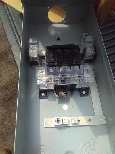

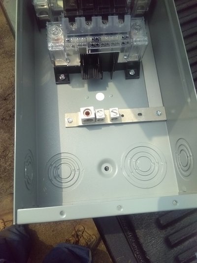

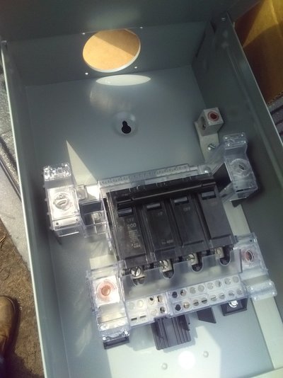

I found this box is made for the job, a "Service Disconnect", and bought one from Home Depot for $185. It will be mounted to the right of the meter, with a 2" steel conduit nipple
between them.
I am also told we will be using special grounding bushings on the end of the nipple threads, both to protect the wires but also have a lug for a #6 ground wire to bond the 2 boxes together.
The new box has a hole in the top, but a cover was included in the shipping box, which I will install to cover up the top hole.
See pix of both 400 amp meter box, and the new service disconnect.
