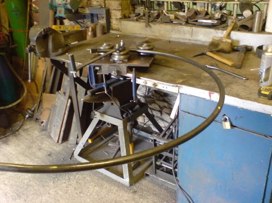

love those rollers wyn, are they home made or shop bought?????
