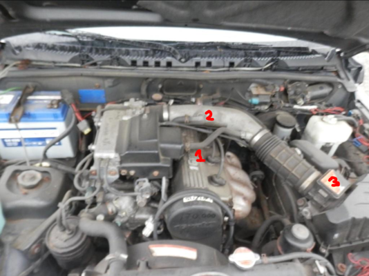

Just trying to figure out what the air intake will look like on my buggy as I need to get an idea of where the MAF will be located so I can provision for it in the wiring loom.
The pic below shows the engine in the donor car. The MAF (3) is located by the air box. There's also two small air hoses that Tee off from the main 64mm pipe labelled (1) and (2). Hose (1) goes to the cylinder head, so is that just a breather? And (2) goes back to a component that has the IAC / Idle Controller on it. So is this an air intake for the idle control mechanism? Do these two hoses have to be downstream of the MAF ? Could they also draw from a separate filter, as I'm not sure how I will Tee them into the main intake if using universal air intake parts.
