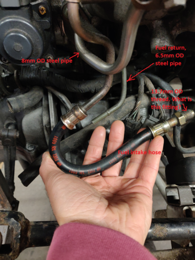

Hi. Would anyone who's done a custom fuel system on a kit car or buggy share how they did it?
My buggy will be running a 1.6L EFI engine. The fuel intake on the engine looks like a AN connection and the fuel return from the engine is just a barbed metal pipe. The fuel tank I've ordered has 10AN connectors. I also have several metres of 8mm plastic poly fuel line left over from a previous project which I was hoping to reuse. The generic fuel cell/tank I've ordered has 10AN outlets.
I've done a bit of Googling, and the Bosch 044 type external fuel pump is the most common I've found on custom builds. It's an external / inline pump which is great as I don't think my tank can take an in-tank pump. Does anyone have experience with this type of pump and is it what I should be using ?
There don't appear to be any AN to compression or AN to poly tube fittings available, these AN connectors seem to be designed to be used with rubber hose or aluminium hard line. I also don't get why the 10AN fittings go to 5/8 aluminium hard line. Who runs 5/8" / 15mm fuel lines?
