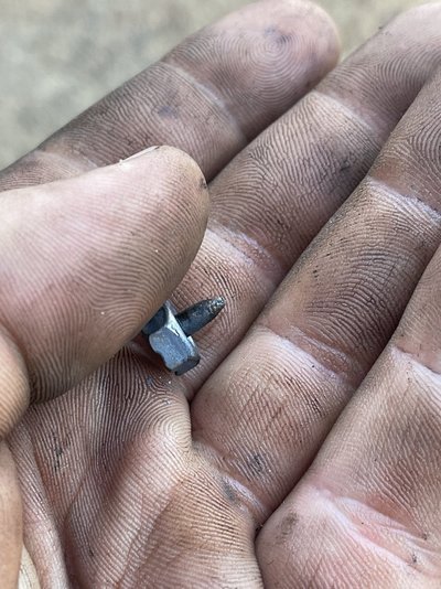

Any spring suppliers that can supply a one off?

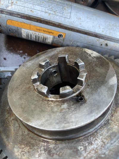

Rebuilding the mill today and I've fallen at the last hurdle.
Detent balls and spring missing.
Now the balls I'm sure are 5/16" diameter along with the springs. But I need to find another spring.
OD: 5/16"
Wire Thickness: 0.047"-0.050"
Length 0.735"
Springiness: Pretty stiff - you can compress it maybe ⅛" in your fingers

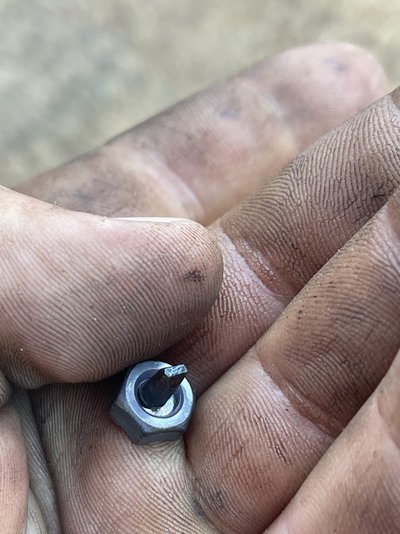

Then there is the way the springs are retained. Pin with chisel points. Had to TIG weld to the only one to remove it to measure spring. So will need to remake these.
(Note nut has been welded on to remove)
Just what I need a load of parts to find/acquire/make.
