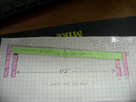

Hello all, I’m after some advice. I’m planning my garage build which will be starting soon. My garage will be 3.25m wide but the roof will overhang, maybe to the overall width of 3.5m or slightly wider? (Excluding gutter width). Anyway, what would the fall need to be on that span?
As of this current moment I can’t remember the name of the material I was going to use but it’s like a big rubber sheet that gets stuck down and is already pre made to the size you want. Hopefully people will know what I mean haha. Thanks
