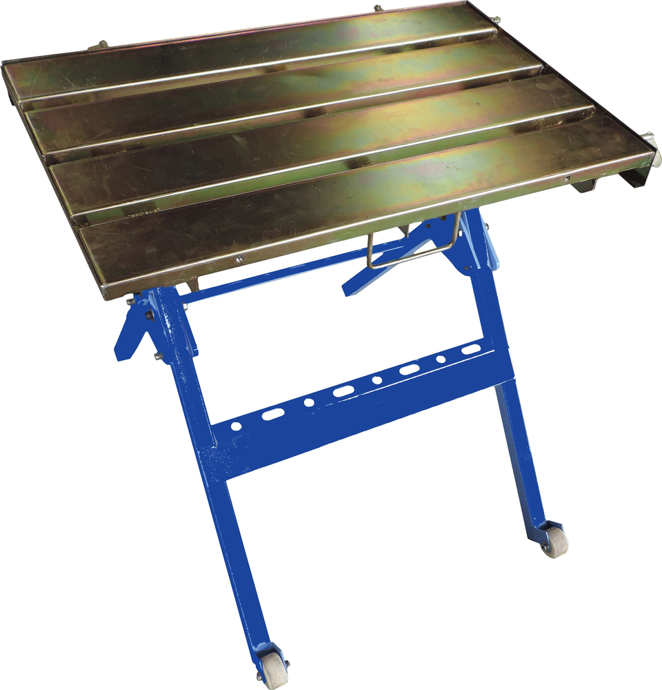

well your only welding on the table , not welding to the tableI was looking at buying a welding table but just noticed in description it is only 2mm thick and zinc coated.
Is it a good idea to zinc coat welding tables?
That is about as mad as a description of a welding table as I could imagine.I was looking at buying a welding table but just noticed in description it is only 2mm thick and zinc coated.
you dont need a full sheet ,, many folk will sell you what you want , if you have a local laser cutter the possibilities open up greatly ... remember welding bench / tables can be slats, box ,channel, i beams or angleIt was advertised by the makers as a mobile welding table.
I was just quoted £600 for a sheet of 6mm
And you wont be just welding on it,you'll be beating the carp out of something against it,standing on it,place to dump a gearbox and or engine on it,have 100's of angle grinder cuts to it,and when you carrying it around you'll catch some part of your body that'll make to curse,lolyou dont need a full sheet ,, many folk will sell you what you want , if you have a local laser cutter the possibilities open up greatly ... remember welding bench / tables can be slats, box ,channel, i beams or angle
