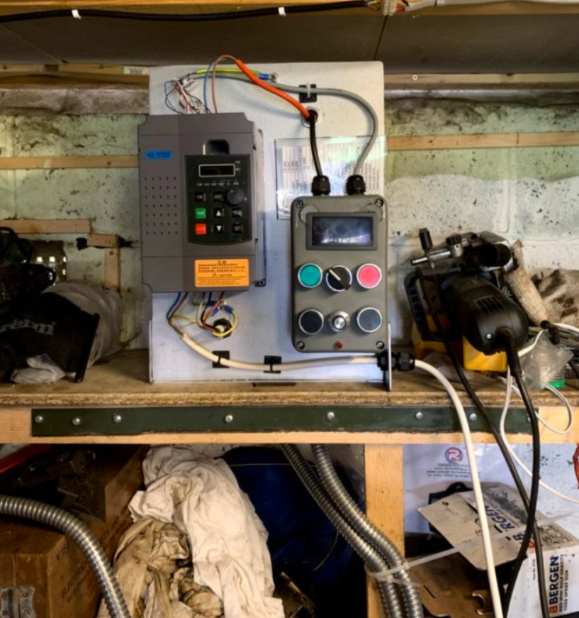

I can't be the only person who loves this kind of thing, right?

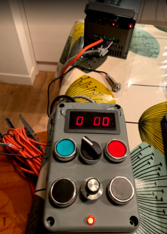

Bought some shiny switches and, with the help of the smart folks on here, figured out how to get it going with:
I'm waiting for my latching switch to cover the forward/reverse, and the pot for external speed control, then it's build-a-box time!
- Momentary push to Start
- Momentary push to Stop
- Jog forward
- Job back
This is for a YL600, but the config should work with a YL620 too, so in case this helps someone else:
P00.01 = 1, external start/stop
P00.16 = 2, three wire motor control
P00.17 = 5, X1 = jog forward
P00.18 = 6, X2 = jog backward
P06.17 = 1, jog acceleration time
P06.18 = 1, jog deceleration time
P07.
P07.16 = 8, jog forward frequency
P07.17 = 8, jog reverse frequency
Connections:
X1 = NO jog forward
X2 = NO jog reverse
X3 = NC stop
X4 = open: forward, closed: reverse
X5 = NO run
Updating the config now that I've got an external pot for speed control:
P03.12 = 5.5, analog input minimum frequency
P03.13 = 60, analog input max frequency (the external pot was only pushing to 44Hz so upped this so that "full on" is now around 54Hz)
P07.08 = 3, Analog input for frequency selection #1
P12.00 = 6.1, rated motor current
P12.02 = 4, Motor pole count
P12.19 = 10, PWM frequency (decrease audible noise)
Connections:
X1 = NO jog forward
X2 = NO jog reverse
X3 = NC stop
X5 = NO run
5V --- External pot top
AIN -- External pot wiper
0V --- External pot bottom
