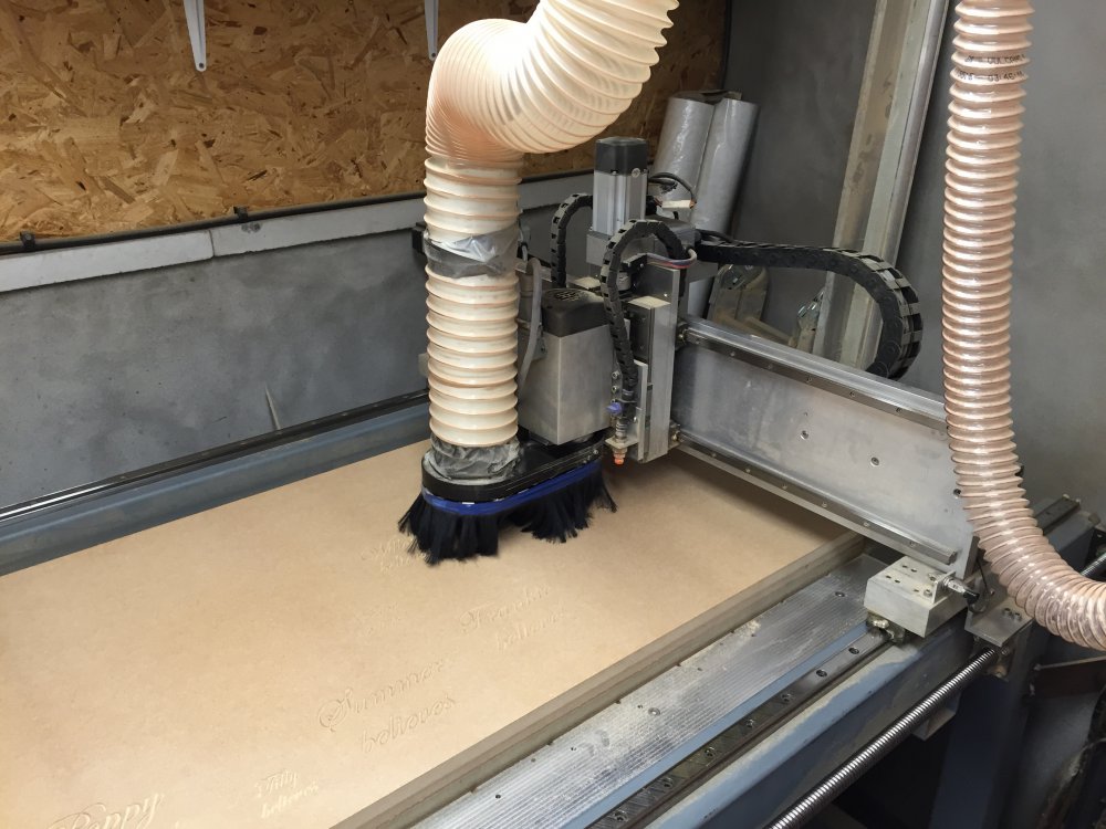

In the real world, you'll need 6 rods per movement involved, so 4 for z axis, and 4 for the spindle if its stepper driven + a few more for limit switches on the Z, rpm encoder pulses if you want to make it closed loop etc. Your going to have a machine resembling a spoked wheel with 10+ spider finger sliding contacts even for a barebones setup.
Or you could have a wire with 10 conductors in it inside a bit of spiral wrap wire tidy with a elastic band to keep the wire from sagging at one end of the travel like my 3d printer has on its print head stepper wiring, or buy a plastic caterpiller track off ebay for a few pounds and do it the professional looking way.
