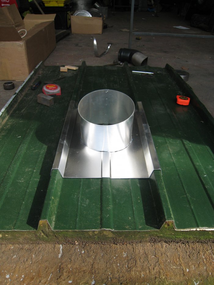

Phoned around looking for a roof flashing for the flue in the workshop and they wanted £65 for one so had a look in the scrap alloy bin and knocked one up myself, luckily I had an offcut from the sheeting when I built the workshop to use as a template.
I will peel off the top sheet and fix that to the underside of the ridge and run it over the top edge of the flashing to keep it watertight along with a squirt of clear silicone.

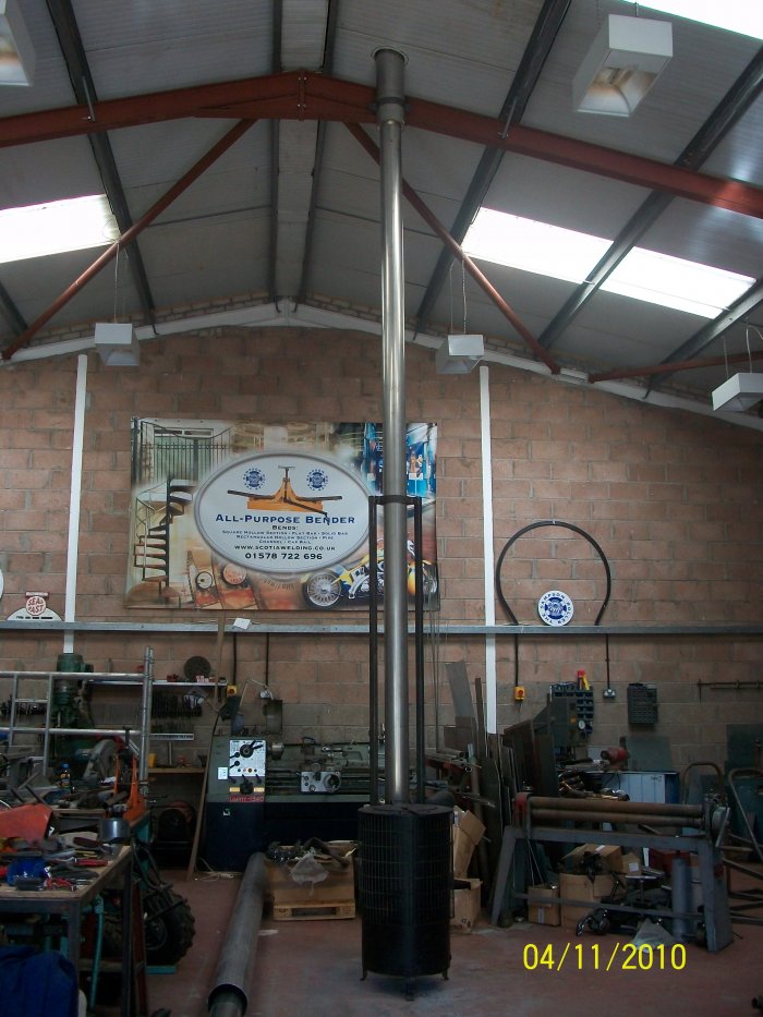

Completed the workshop heater today 28 deg outside in the sun cant wait for winter.
Made a twinwall section 25mm air gap all around and 50 mm from any combustable material as it passes through the roof, also found out that the vermiculite which I used to fill the 25m gap compresses by 10% to combat this it was mixed with 10:1 with dry cement no sand this binds everything together and keeps it in place.
