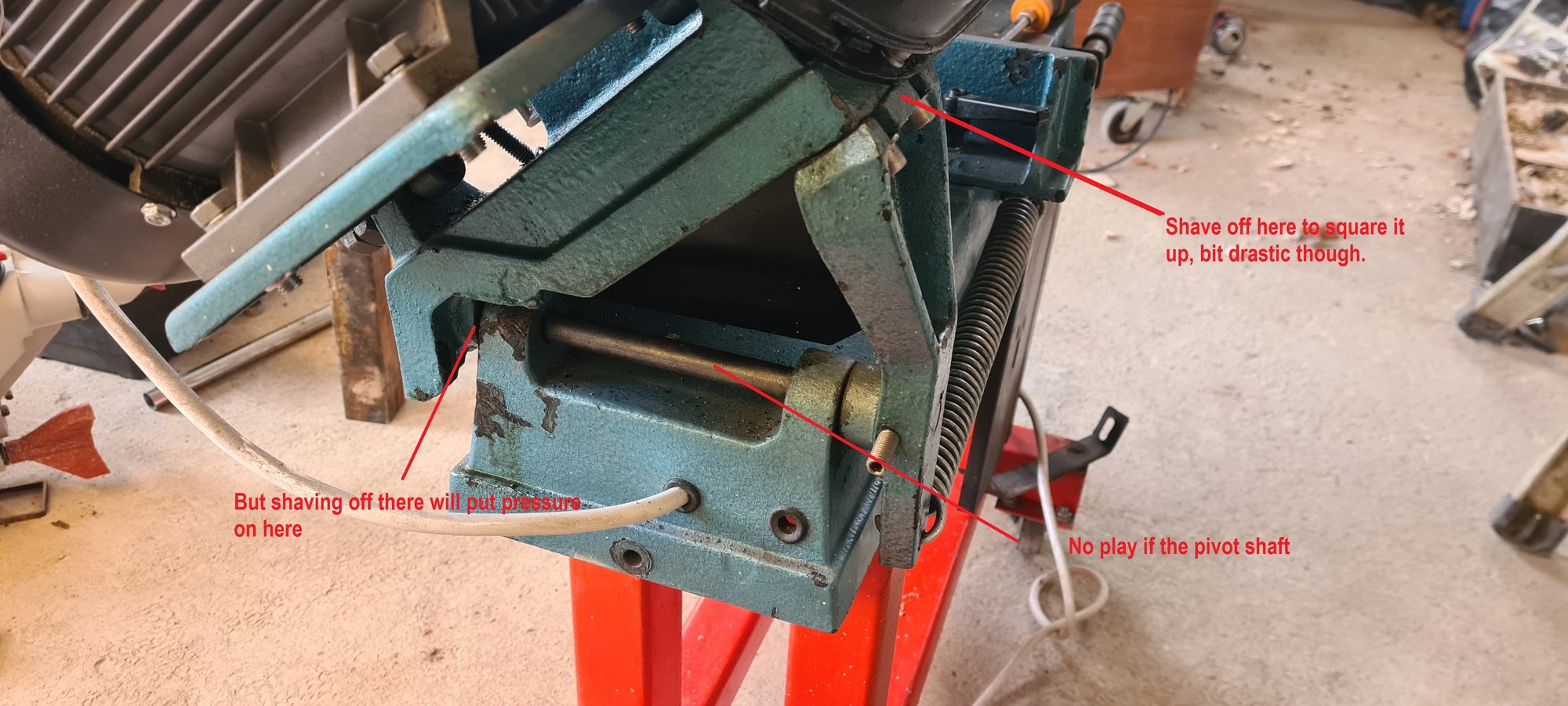

Yep, that’s what I did with mine. See post #13if you have a lathe you could machine an offset pivot spindle. It might even be bent (have you checked.) in which case rotating it might even bring it back into alignment.

I have the same saw & for years it cut perfectly square once you set the blade square. (hint - to make it easier to set the blade vertical clamp a 6" steel ruler to it)
Then is started cutting off square vertically like yours. I tried everything, nothing made any difference. Like yours, the bow looked like it was off square when you lifted it a few inches.
I tried shimming the bow where you suggest shaving a bit off, made no difference!
I thought the guide wheels were taking the set off the blade so I beveled the edges of them a bit more - made no difference!
I desperation I gave in & bought an adjustable motorbike steering damper off ebay, fitted it & suddenly it cut perfectly square again! You can try supporting the bow manually while cutting but its impossible to provide the constant drop rate the damper gives! If I wind off the damper it goes straight back to cutting off square so its definitely working.
It was truly one of those 'why didn't I do this years ago' moments!
The fitment was quite simple, drill & tap a couple of holes. I can post a photo if you want.
An experimental damper can be created from one of these with a contrivance for letting the air leak slowly:That was my first thought aswell so was going to get a damper but then tried to drop it manually as thought that would be the same to control it, but no difference. So manually does not work so ill get a damper for sake of £30 and try it.
And ill go check the pivot shaft.

i could, but with all the hassle and time messing about doing that i would rather buy a good one that works.You could cut the cast lugs off the base and fit a couple of pillow block bearings on spacers and shim it.
