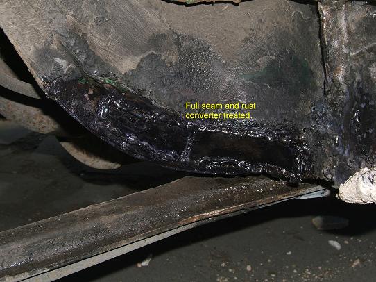

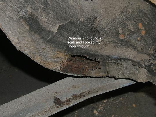

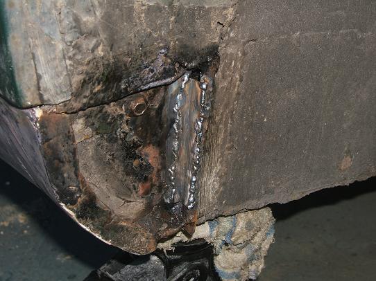

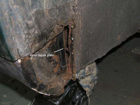

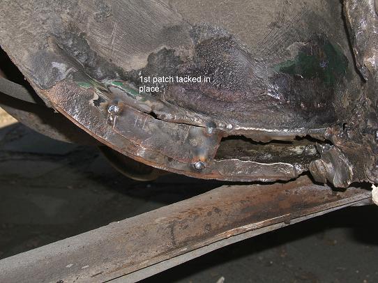

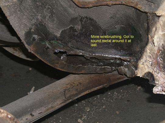

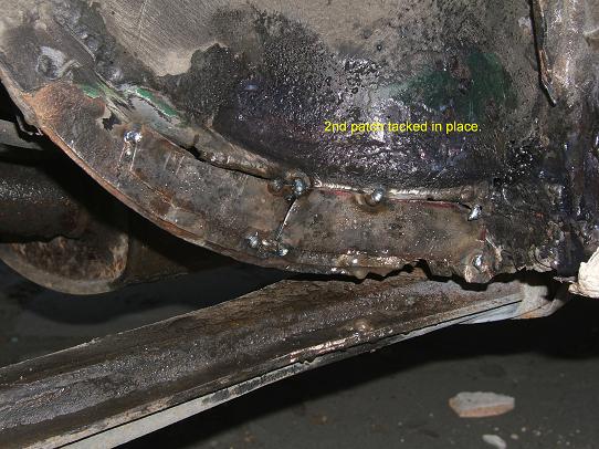

I cleaned back to sound metal around it, fortunately it had not spread too far. Then I used scrap pieces actually cut from this Daimler to patch the pieces in place.
