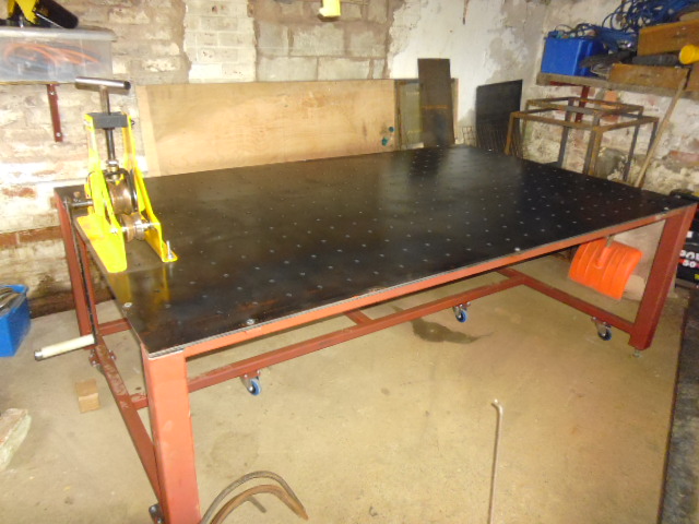

If braces were needed, they could be fitted a couple of inches below the table underside with only the bolts coming up to the table top between the mounting holes, But as you say not tacking to bench and heavy work onto another table.
I was thinking of some 40x10 flat bar thin edge vertical between hole centres if it ever proves needed. I really want the clear access to the underside though
