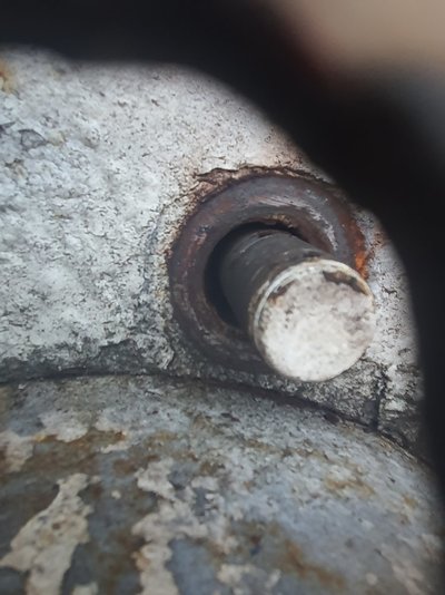

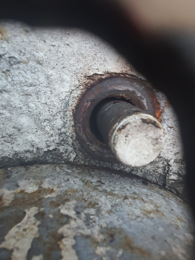

D dchqbam41 New Member Messages 2 Location Warrington UK Dec 14, 2021 #1 What would be anyone thoughts on welding a wheel rim from a ATV Mobile crane as the holes for the studs have become elongated Or does anyone know a company that specialises in the whole process Thanks andy
zzr1200 Working at 650 ft on open steel work. Messages 5,486 Location Glapwell, Chesterfield, Derbyshire, UK Dec 14, 2021 #2 New rim required, imo...
D dchqbam41 New Member Messages 2 Location Warrington UK Dec 15, 2021 #4 That's what I thought aswell TBH

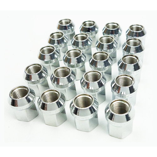

J Jack Ryan Member Messages 556 Location Adelaide, South Australia Dec 15, 2021 #5 I don't know where this is used - public, private - but while you are waiting for replacements, can you use the self centring type of wheel nut? It looks like those in use are flat. Jack
wyn Member Messages 3,592 Location Cardiff Dec 15, 2021 #6 It looks like the nuts just provide the clamping force and do not "Locate " the rim on the hub.
