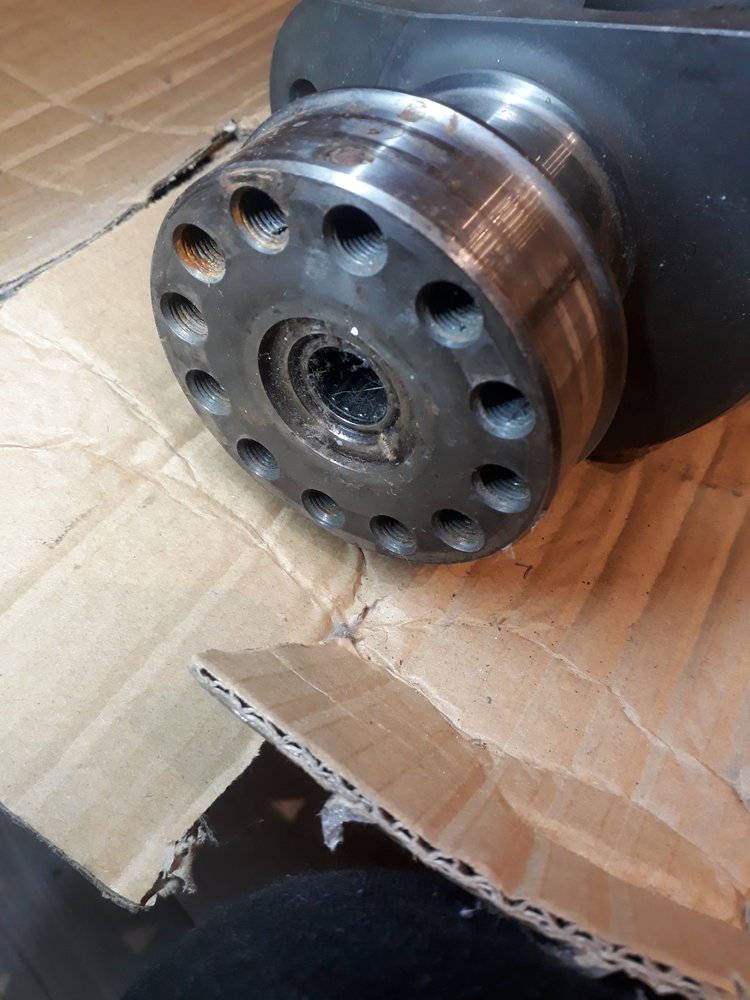

I might contact arrows see what they say
I suspect Arrow might well tell you the same as they told the previous owner?
I was going to get some quotes in the week see how much it is to put it right, thanks for all the replys
That's going to be Some undersized grind @hotponyshoes
Be surprised if it isn't nitrided EN40B if it's from Arrow precision. Anything more than .010" will be through the nitriding. If/when you get it ground, it might be a good idea to get it done by Jason Howes at South Kilworth, Jason used to work for Arrow precision, and was still doing work for them last time I was up there. If the fillet radius on (especially) the big ends isn't preserved when regrinding, you know exactly where the failure will occur.Hi it is a billet steel crank I think it's made by arrows, I'm all ears the guy I got it from said it's a easy fix he said just tig it
I'm pretty sure they'll say 'buy a new one from us'I might contact arrows see what they say
