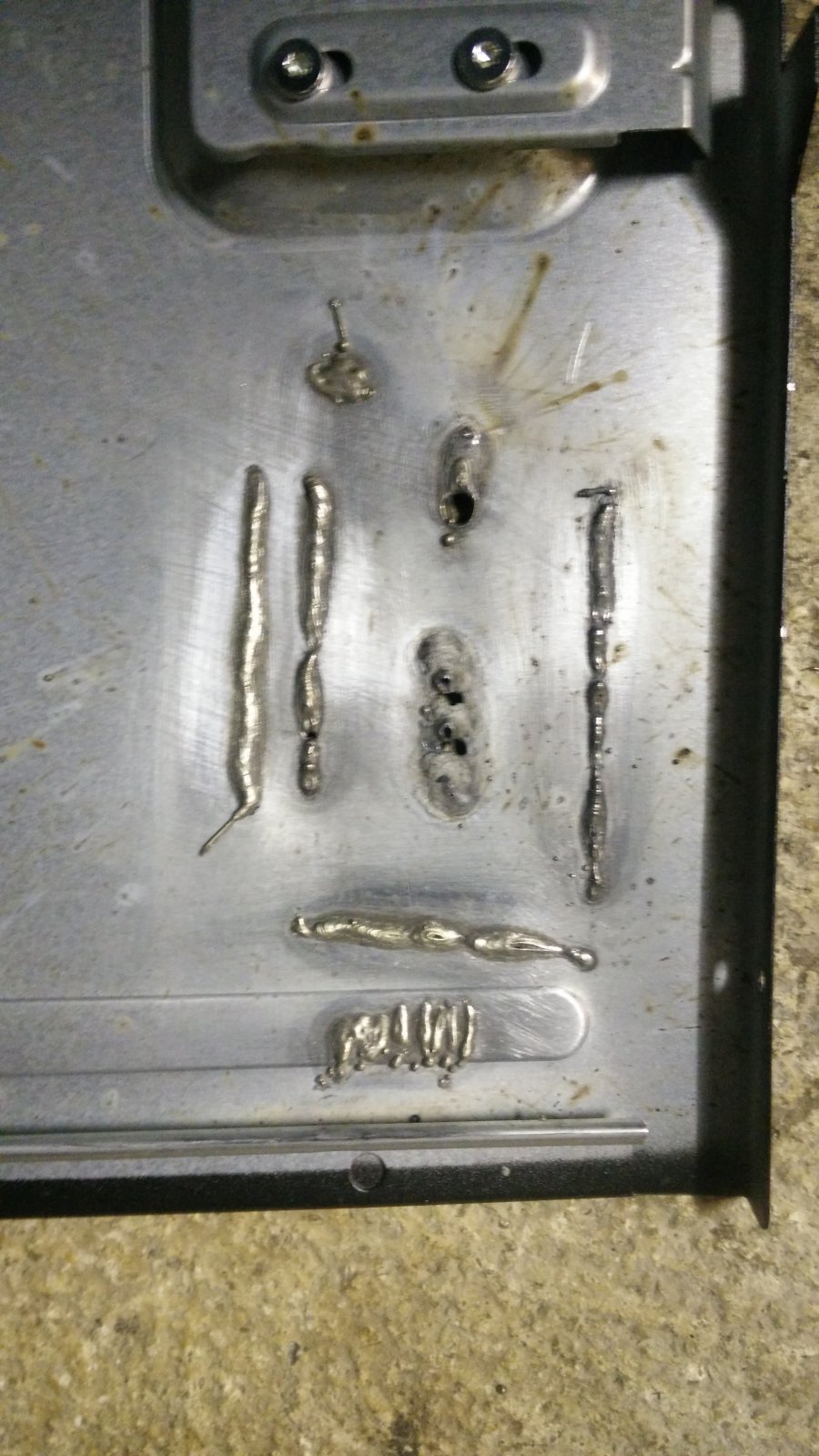

Good point, it came with flux wire and the chap said it was set up for flux, I must admit I just took his word and didn't check. Will have a looksie to make sure.
The other thing to remember is the max thickness off a 90 is 2mm so 1mm you need to be on max 1 /min 2 depending on what weld your doing butt fillet root gap etc
