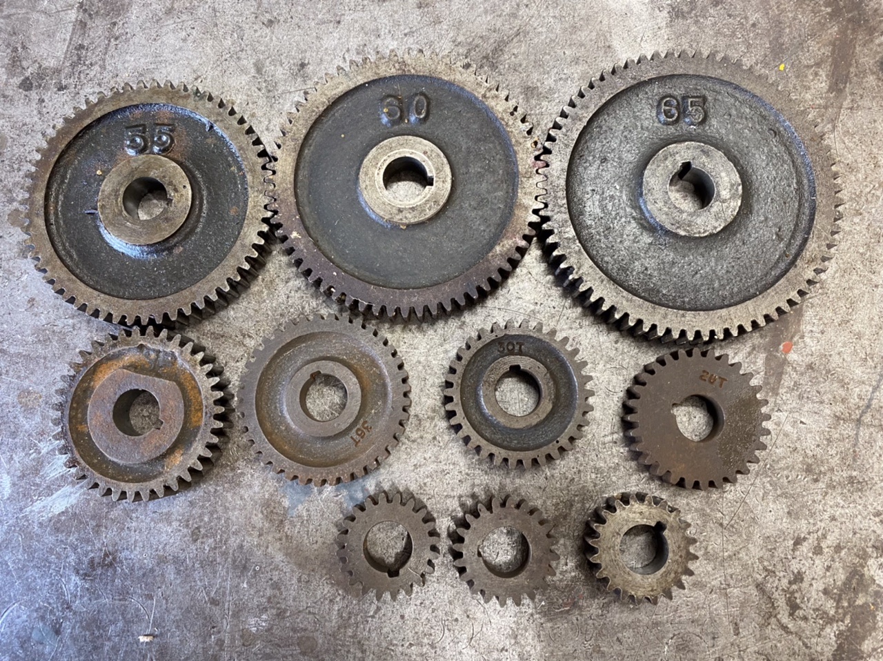

Anyone recognise what these change gears are off? They are slightly larger than Myford gears, teeth have more rounded profile.
Thanks, I am away from workshop but I’ll measure up tomorrowA common one would be Boxford. 9/16" bore. 18 DP from memory.
edit.
and 3/8" thick
