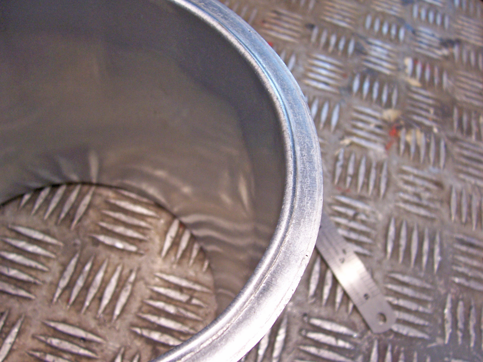

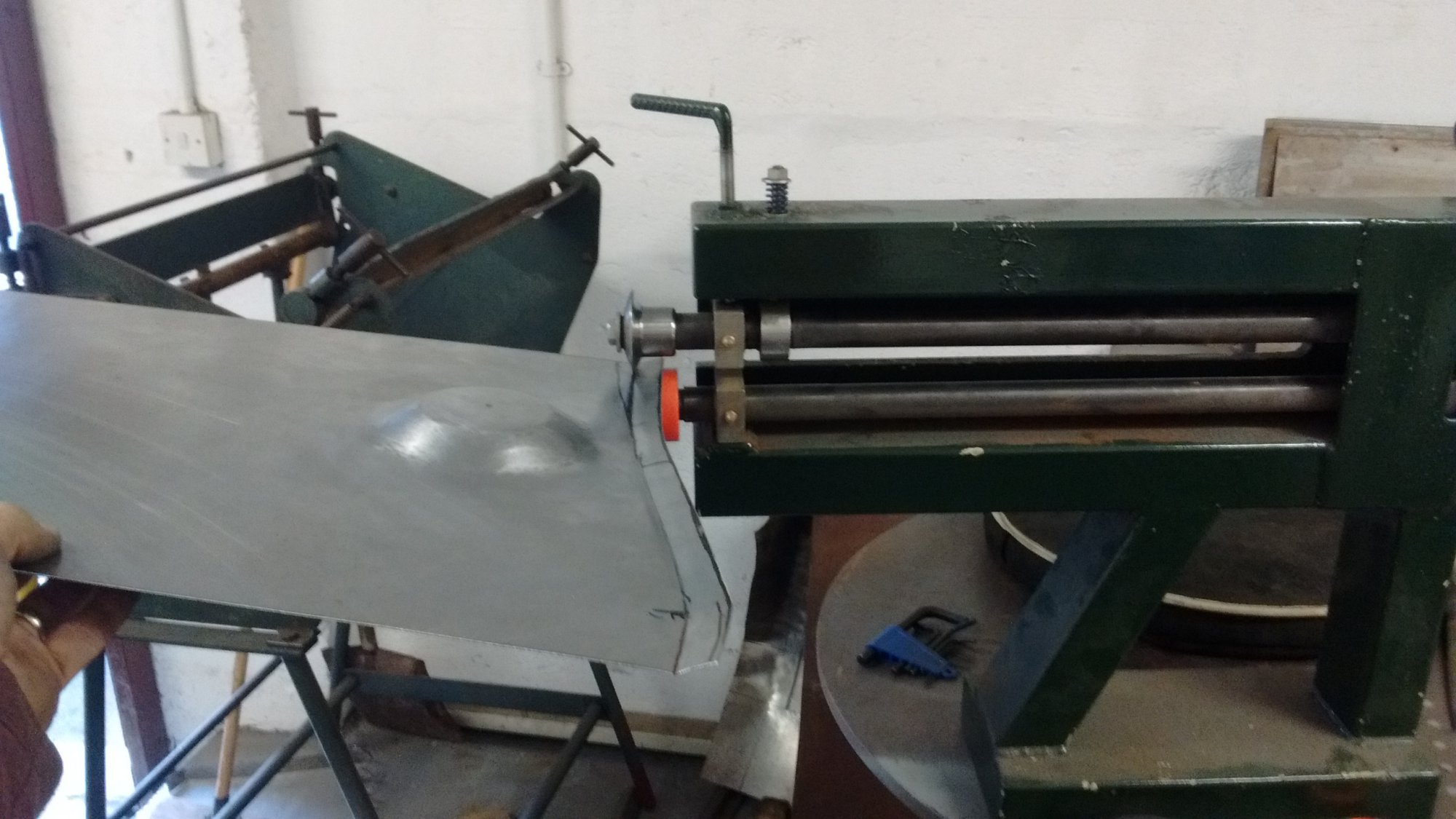

!st pic shows the scrap test. Best one of all. Shows the "P" shape to the bend.

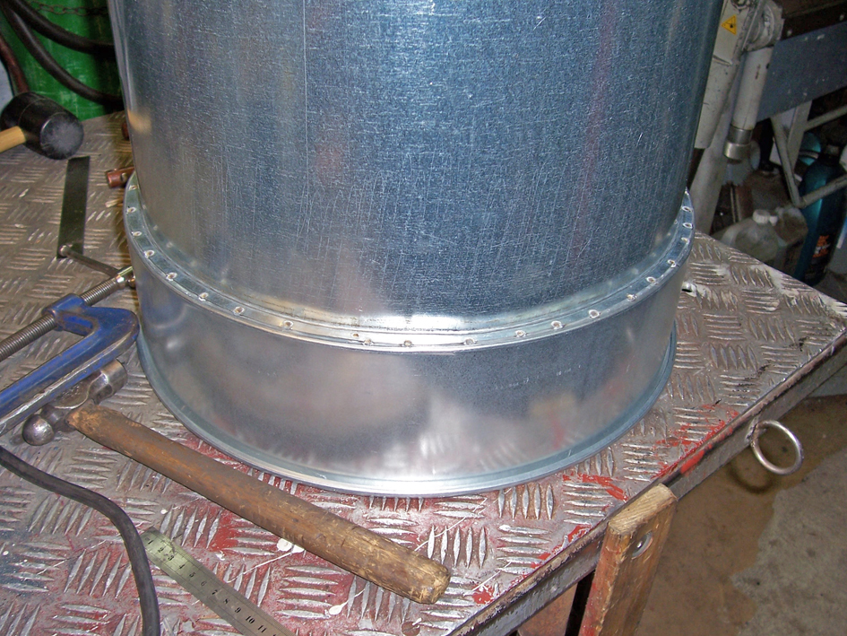

2nd pic shows the final job that fits standard duct to some old non standard stuff. This bit will slide in the old.
A taft turned in spot welded to a taft turned out that overlaps it.
The turned in did ripple a little but dressed flat ok ish. tipping outwards was no bother.
I had a flat hardened anvil but not the same fitment as my Jenny, but a spin on the lathe later and I had an adaptor ring.
VERY pleased with the results on some 1mm galv sheet as shown in the photo. The U grooved anvil that I used Friday
is sitting in the background on the backstop bar.
Just goes to show your never too old to learn, and thanks again for the advice.
