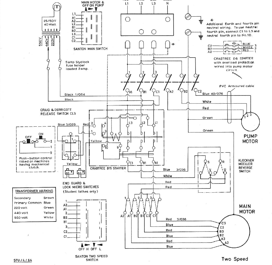

They are the best ones, the newer like I have are rubbish.
Anyway it looks like it has a clutch and the motor constantly runs which would mean it is a piece of cake to just put a VFD on and make a small control panel up if you wanted.
That is as long as it is not a 2 speed motor, if it is then you may not be able to run 240v and even if you can then you would just have to chose one of the motors speeds. There are VFDs that can have multiple motor setups in them but they are not cheap.
