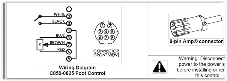

Hi guys I have just acquired a 190 gts I'm new to welding I have set machine up but can't get hf start to work I have to touch the work piece to get an arc I have tried torch with a button and foot pedal. The plug on the torch only has 2 prongs and the foot pedal has 7 could this be the problem? Sorry if it's a stupid question like i say just new to this.
