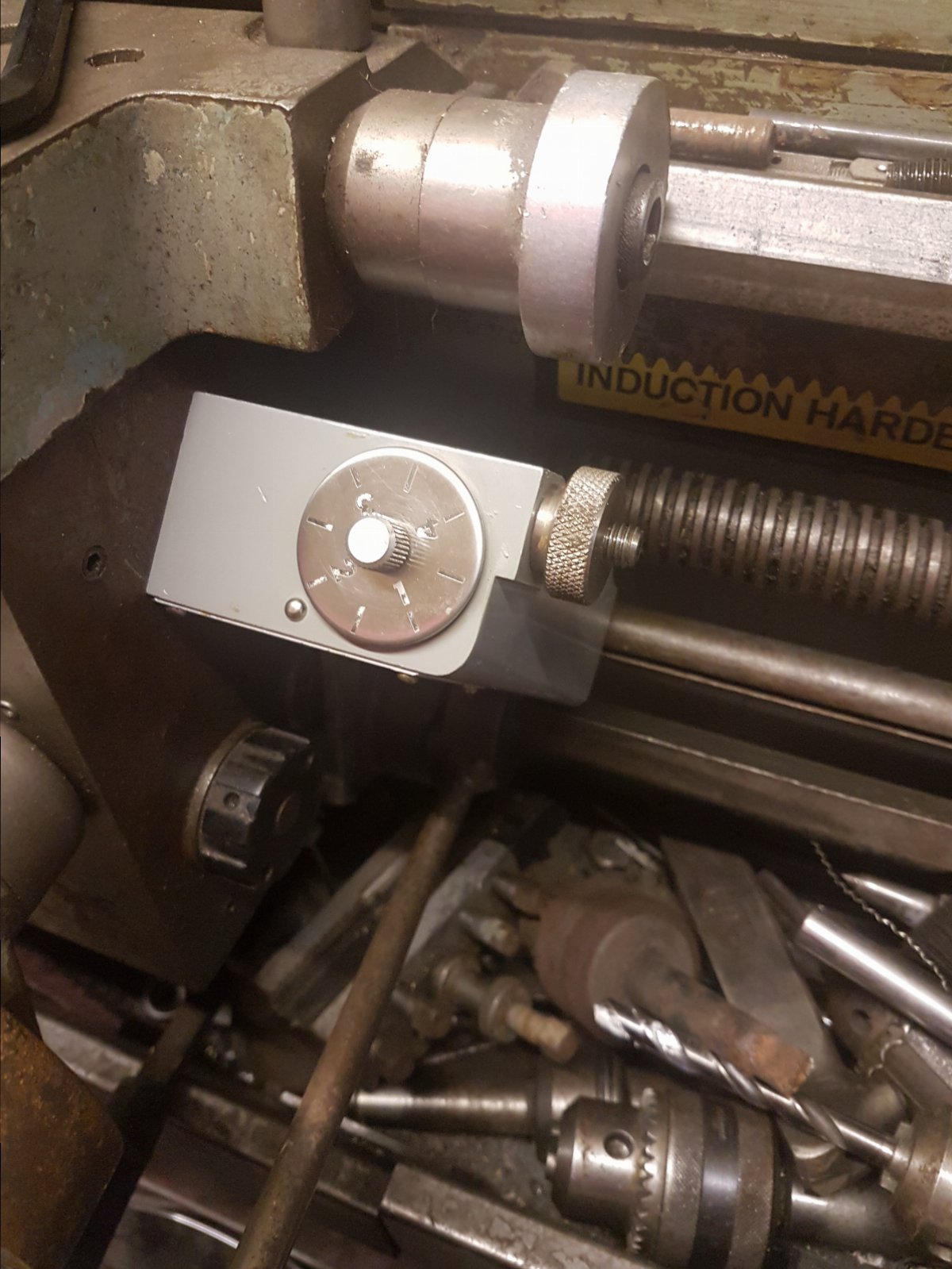

Surfacing??? Not sure what that means mate.If you look at the thread cutting chart on the vertical face of the headstock, it tells you what combination of levers you need for a particular pitch. One of those levers engages the lead screw for thread cutting, but not when you are surfacing (as indicated by the cryptic symbols at the top of the columns)
