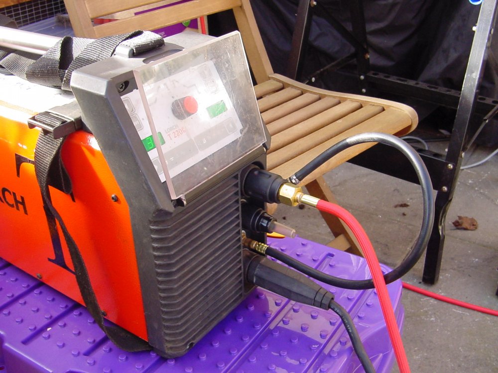

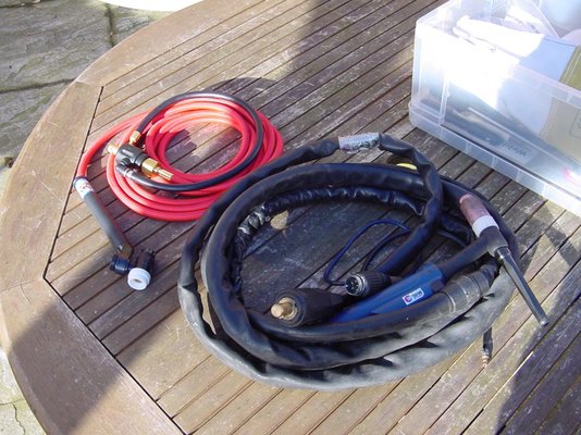

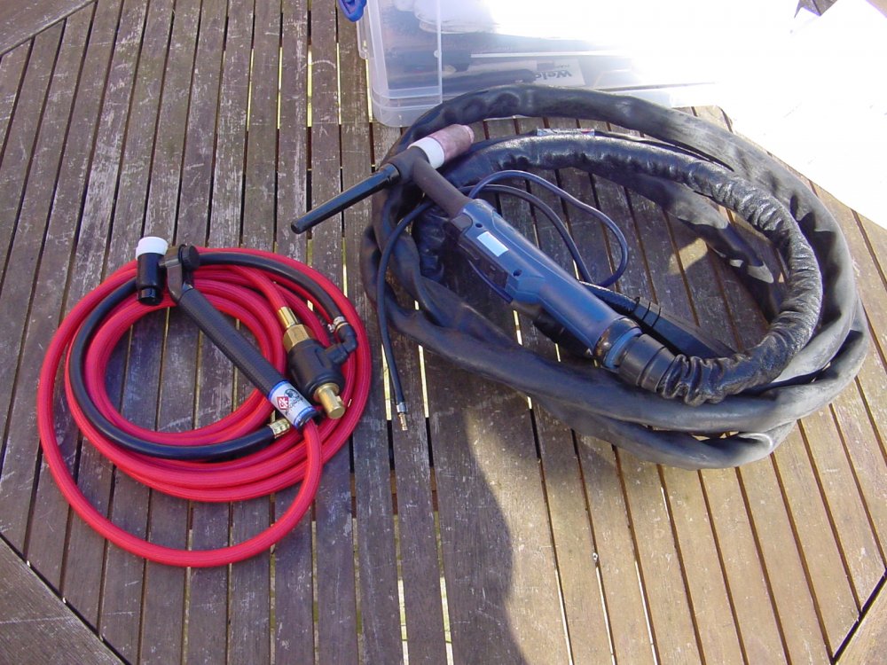

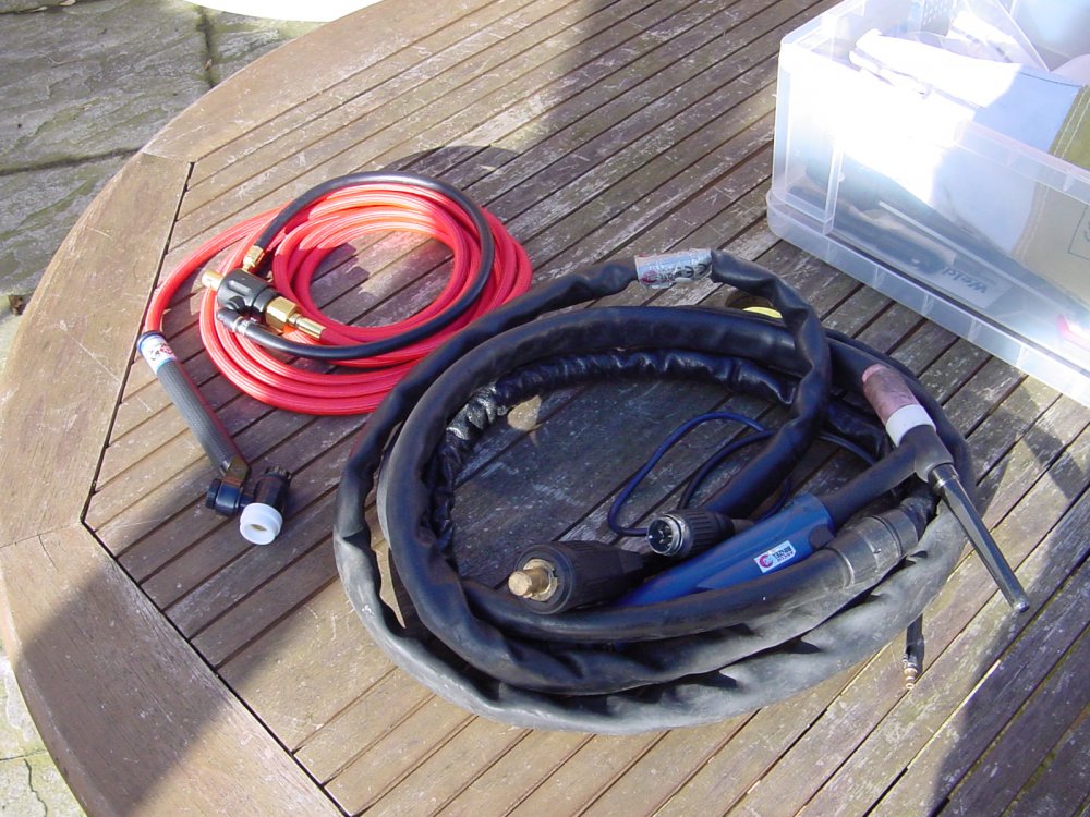

Quick update. torch's arrived (yes I got me the 2 types lol) so after a bit of a drama I managed to get the new ck torch to work
Disconnecting terminal 1 - 2 was the problem in the 5 pin plug, as nothing would happen when bridged !!
Now have a lightweight torch and lead that works a treat.. sooo much easier to use
About half the size of that brick I started with !
Am very pleased and would deffo recommend one
