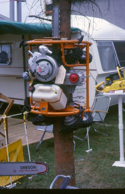

Probably still at the top of the tree.This weird device was exhibited at a garden machinery show in the late 60s. Apparently it climbed the tree cutting as it went. not sure how it knew when it had got to the top! never seen it or anything about it since.

Nobody can climb up to it, cos there's no branches to hold on to.

specially if it was a tree house and u were in it and got the chain up your jaxieIf that thing ever escaped, it could eat your house.
