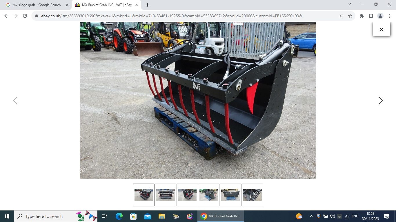

Nope, if it was tight it wouldn't move as there's gaps between tabs, it's a mx silage grab, not overly heavily built really.Does the bolt have to be tight to do its job, or can you get away with a sliding fit pin? Could make a nice pair of pins with circlips or roll pins for retaining...
