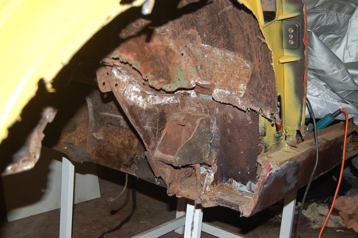

Looking at those pics again, there seems to be rust at the bottom of the LHS a pillar where it meets the sills and the inner sill structure of the car looks completely rotten, which does not bode well for the sills replaced in 2003, possibly the garage that did the job tack welded cover sills over the rusty originals and smoother the join with seam sealer. The paint job also looks flat- possibly hiding poor panels repaired with filler?
