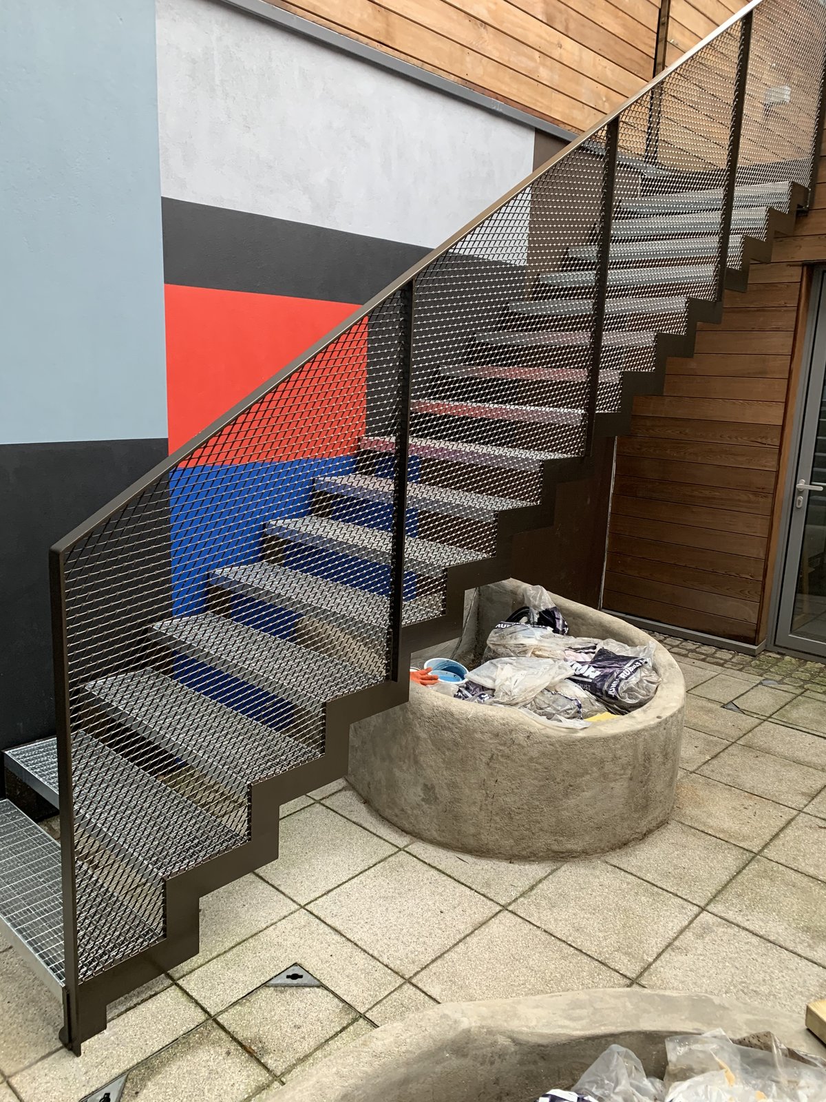

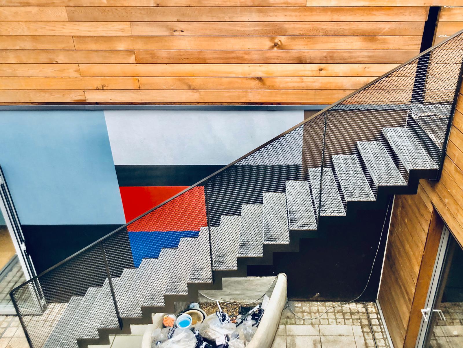

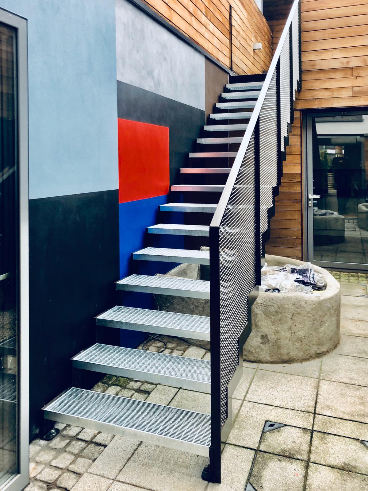

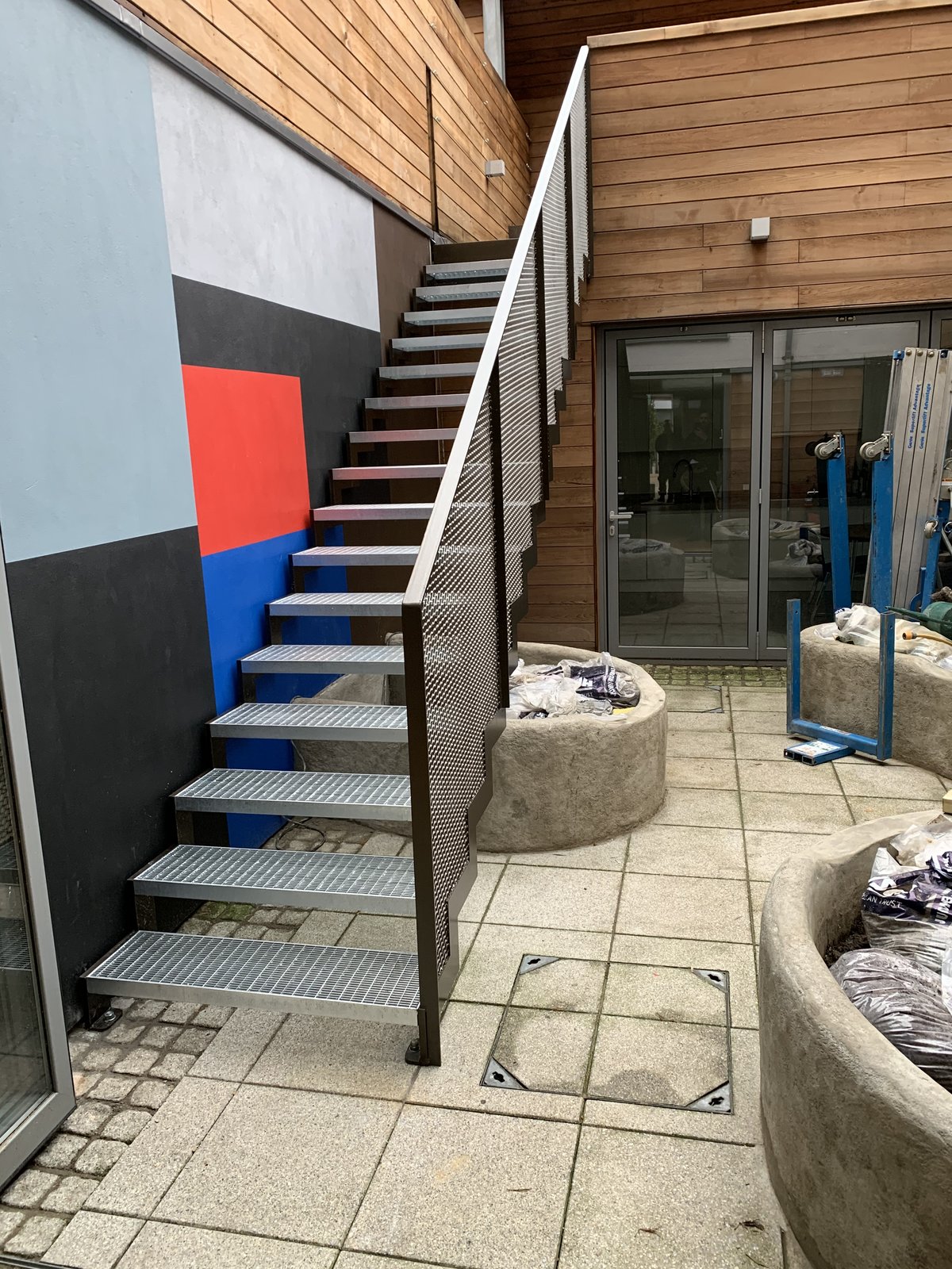

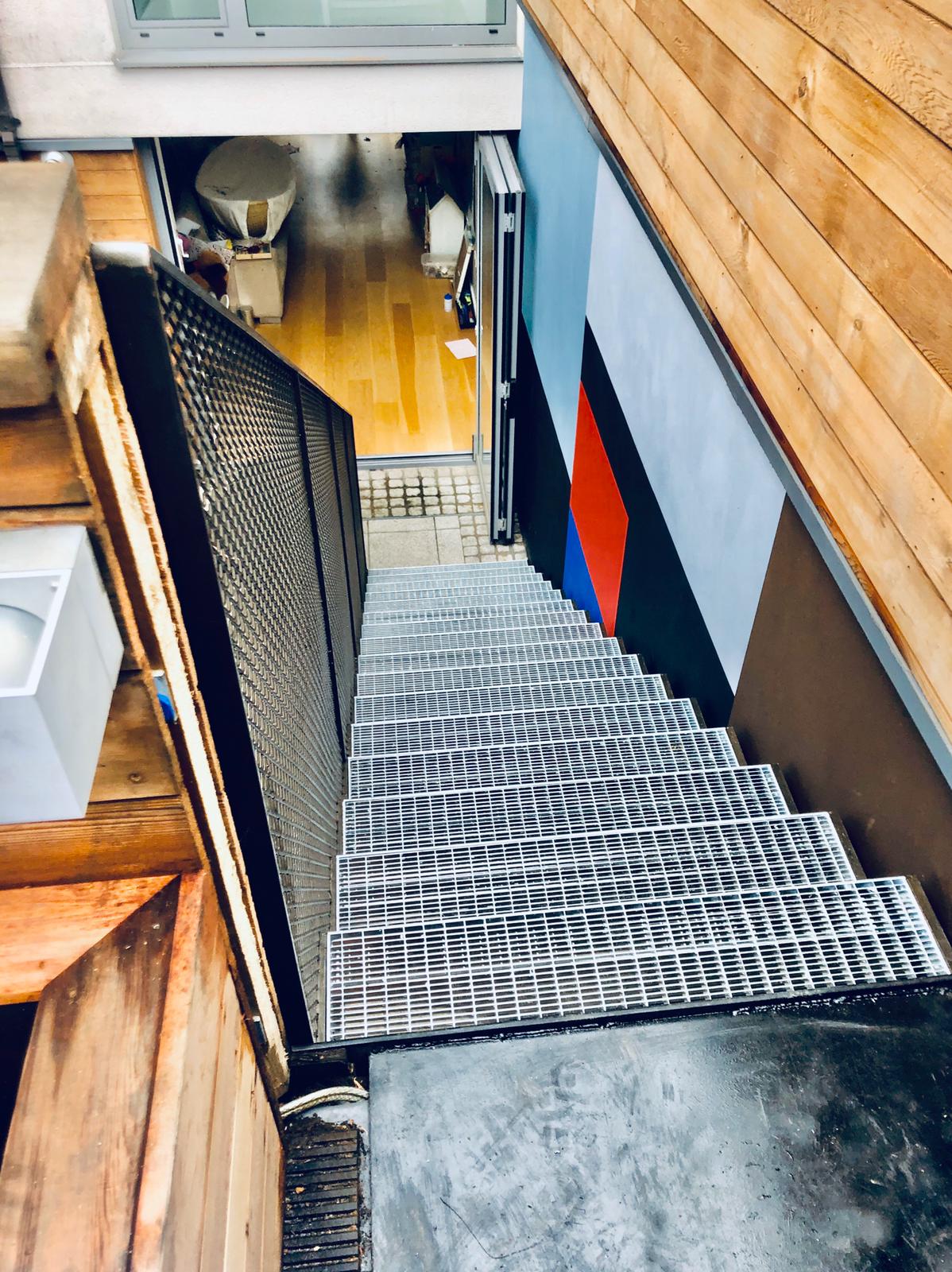

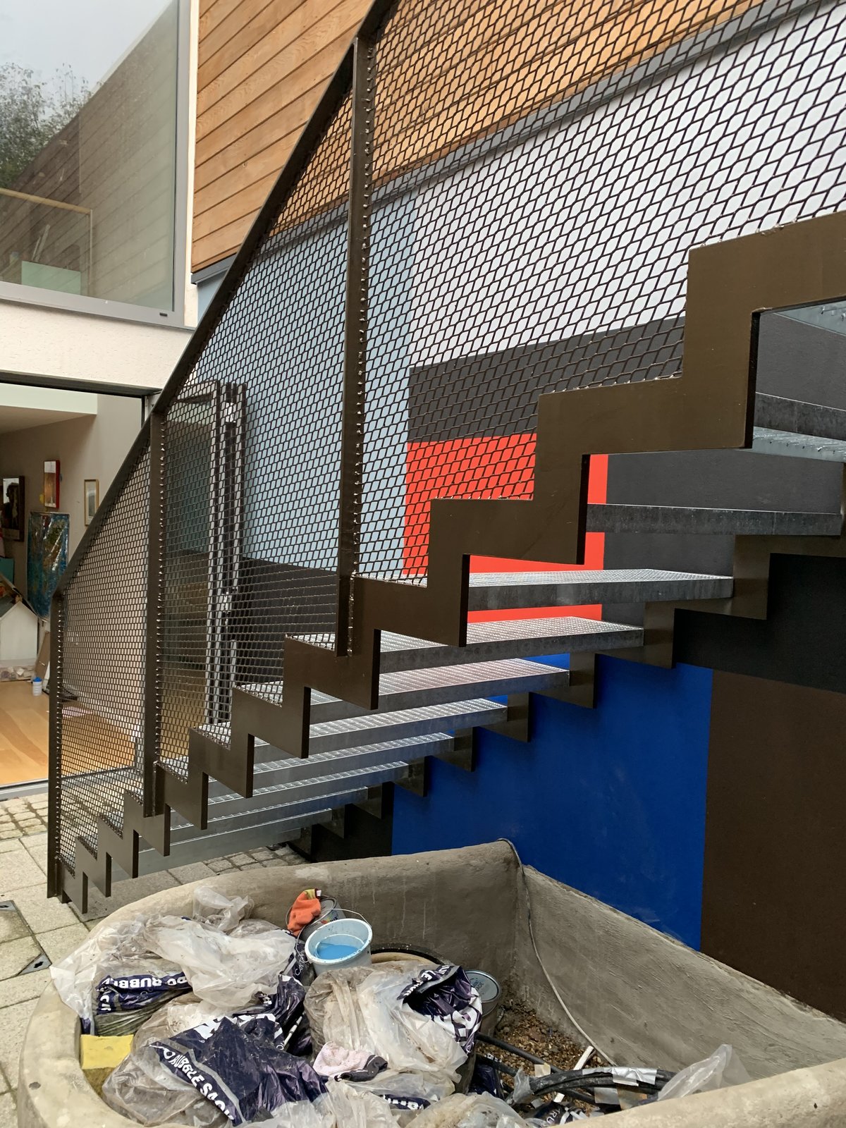

Strings 20mm mild steel. Laser cut in 2 pieces as the rise was 169mm and go in of 275mm
Treads - 30x9 grating welded into 50x5mm frame. Drilled and tapped 15mm into the string to bolt treads in position
Handrail and vertical balustrade 50x10 flat
Hand painted anodic bronze
