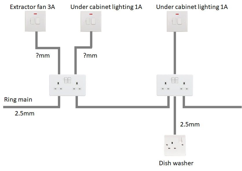

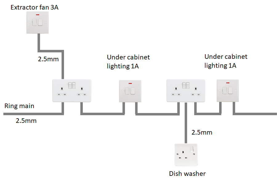

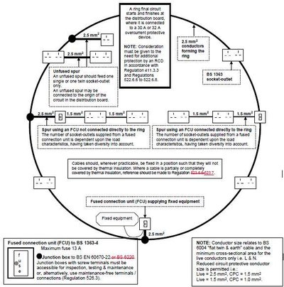

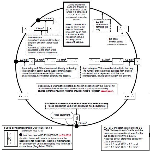

A radial will be fused at 20A, and run in 4mm cable, so no part of the circuit will carry more than the cable is rated for - even when there's lots of spurs.
A ring is wired in 2.5mm, and fused at 32A.
That means it's easy to have a part of the circuit carry more than the cable is actually rated for: especially if multiple unfused spurs are added
Incorrect, a standard 20A radial circuit is more likely to be wired in 2.5mm
Standard socket radial circuits as per BS7671 are 20A or 32A. The minimum cable size for a 20A radial is 2.5mm, the minimum cable size for a 32A radial is 4mm (except when MICC is used)

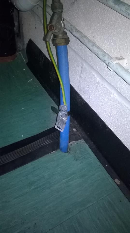

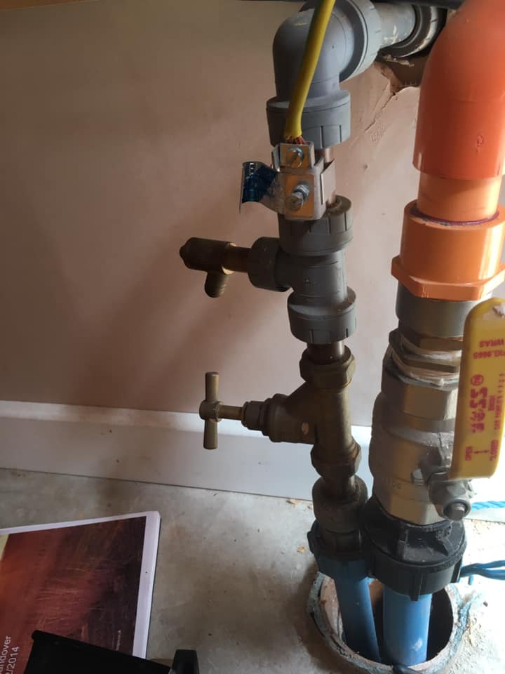

it doesn't need doing .you cant bond plastic just the gas or oil if u have it in 10.0mm earth wireWhat is the deal now on earth bonding, now that heating, hot and cold water pipes are plastic?
Doesn't stop them trying....it doesn't need doing .you cant bond plastic just the gas or oil if u have it in 10.0mm earth wire
yes i have seen that before 20 meters of earth bonding wire and they get the plumber to put 6 inch of copper pipe between the cold and hot pipe under the sink to bond to so much for so called trained electriciansDoesn't stop them trying....
Or put a bit of copper pipe in for the clamp...
