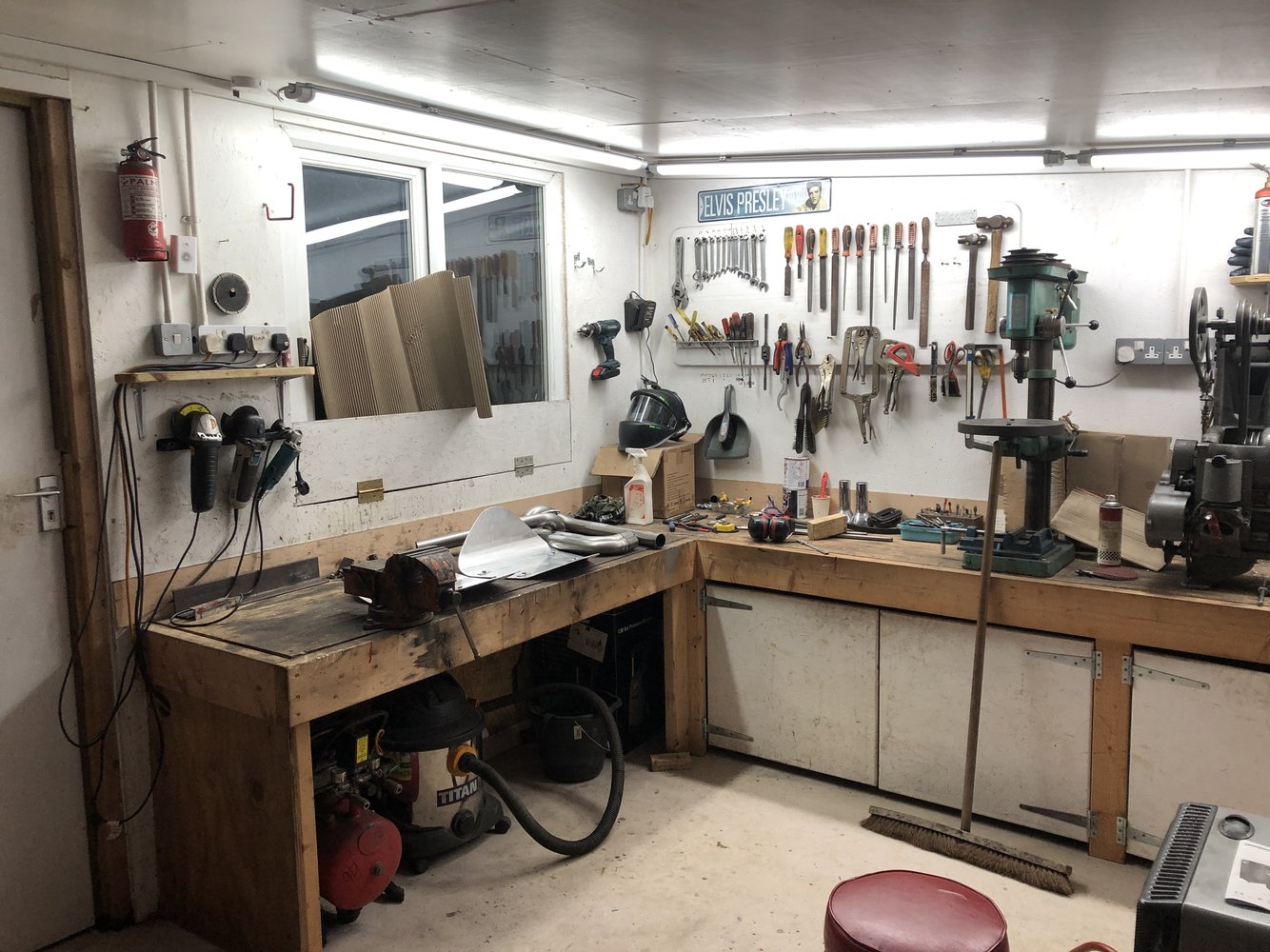

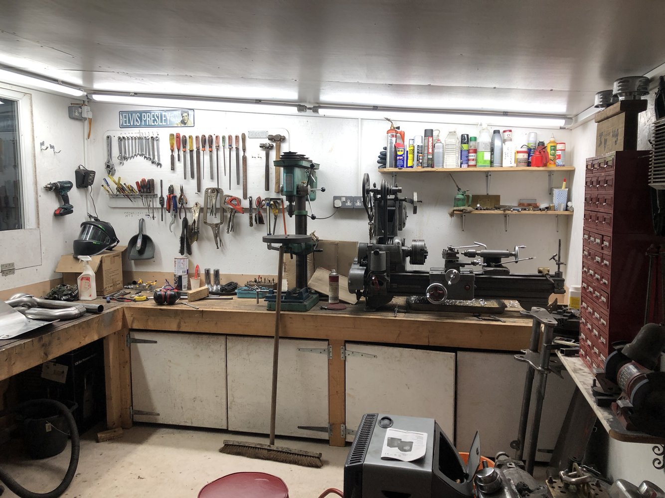

I have 6 x 5' led battens in a 12 x 8 m workshop. Lights the area perfectly.

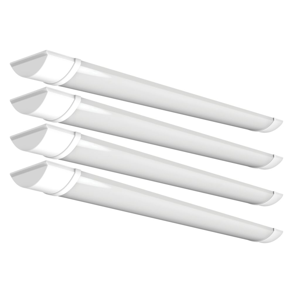

Those are exactly what I have in my 9 x 8 metre workshop, I’ve 9 of them, they light the place up but they’re not massively bright, I still need a plug in light To illuminate what I’m working on.4lite Twin 5ft LED Advantage Batten 40W 4900lm 220-240V 4 Pack - Screwfix
Order online at Screwfix.com. Energy efficient, polycarbonate LED batten with versatile, slimline design. Suitable for commercial and industrial applications. Easy installation, attaches to body with metal clips. FREE next day delivery available, free collection in 1 minute.www.screwfix.com
Was thinking these will do the job! Look flush fitting so perfect as wires will come down through plasterboard. Some of the others look like the cable is surface mounted.
