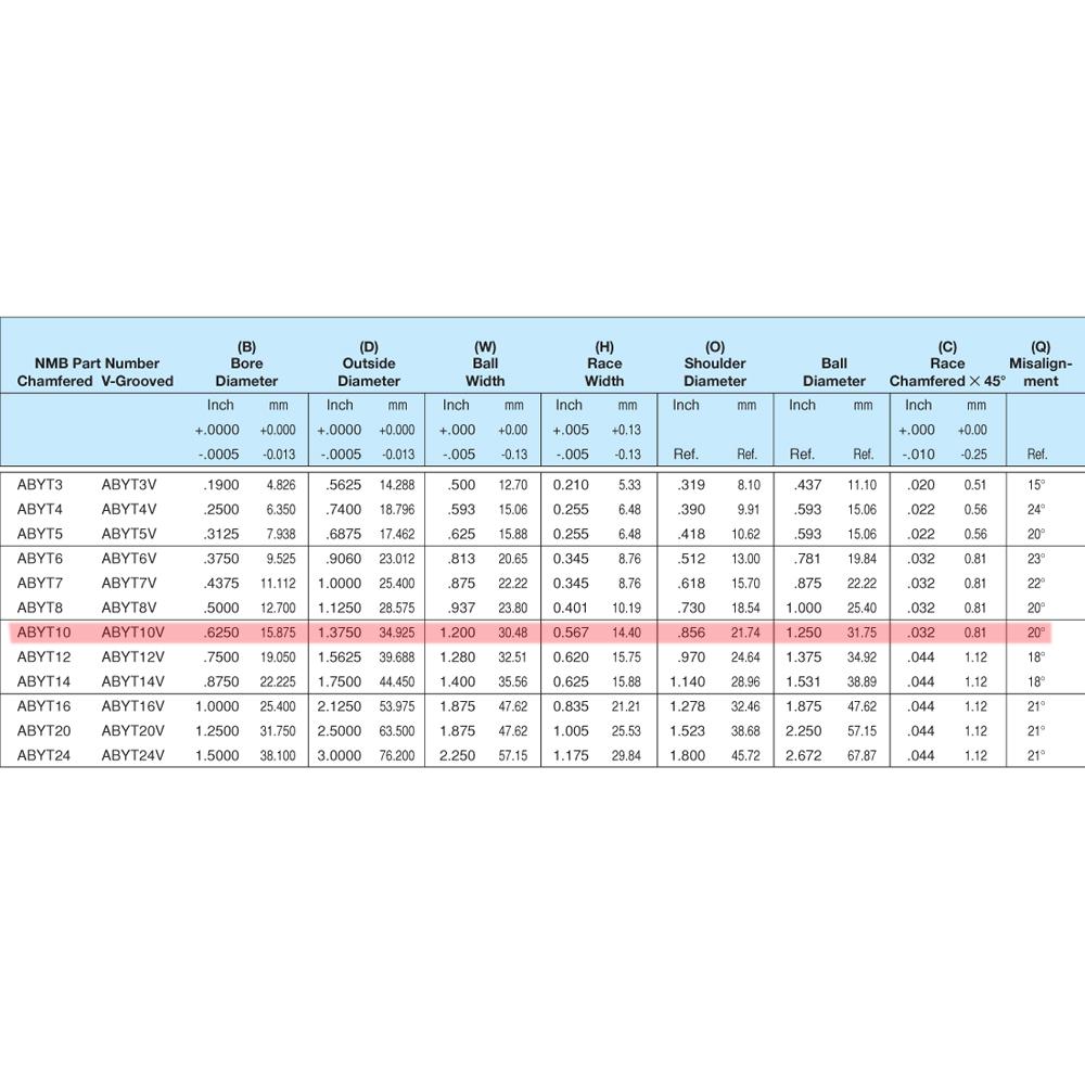

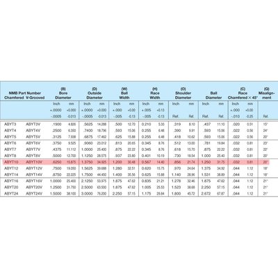

My next wishbones will be made with the hybrid type spherical bearings that McGill do, I think they are a 5/8 inner but with the outer of a 3/4 one then I'm going to use a 5/8 to 1/2" reducer/ missalignment spacer, the housing is 25.5 high and 48.8 in diameter.
