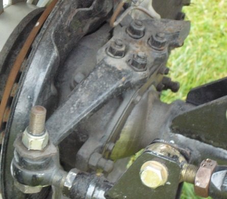

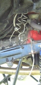

Saw these on a lifted Hilux today, one is some nice 'flexible' brake lines, the other speaks for itself. Enjoy!

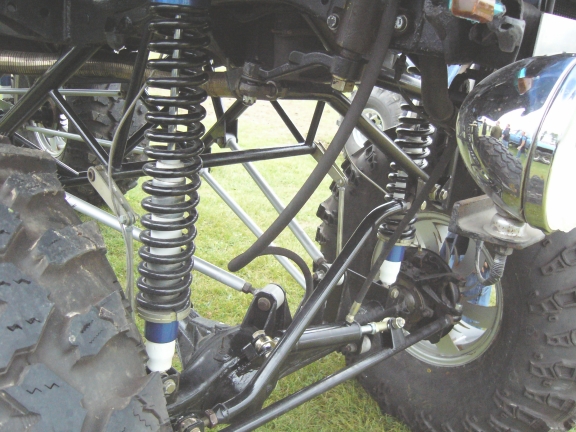

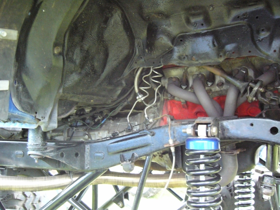

Here's the full pic, it was a 'monster truck' style life, massive coil overs and approx 6" body lift. Looked fun, but the engineering left a little to be desired in places. Yes is was copper or alloy hard piping between body and chassis, the body appears to be on rubber mounts - i'd certainly use proper flexible pipes.
It was a V8
