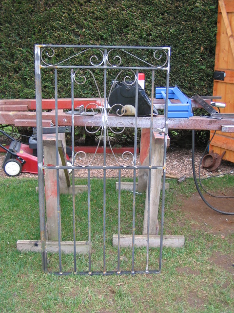

so do i WITH A SPRAYGUNNice gate Sanny, i actually find painting that sort of thing quite theraputic!
Hi, i'm thinking of building a gate a bit like yours, could you please tell me the sizes of materials used? Sorry to sound thick but i'm new to this.
Cheers, Dave.
As you are still waiting a reply I will try and have a guess. It's a great little project for a beginner to be fair.
Box section 30 x 30
Flat Bar 30 x 10
Square infils 12 x 12
Scrolls 12 x 3
That's the first time I have had to visually scale anything off a lawn mower
QUOTE]
Thats exactly what I used, I normally use 30 x 8 flat bar but had enough of the 30 x 10 left over so I used that up.
As for galv and powdercoat, I know what you are saying but some people just dont want to pay the extra.
