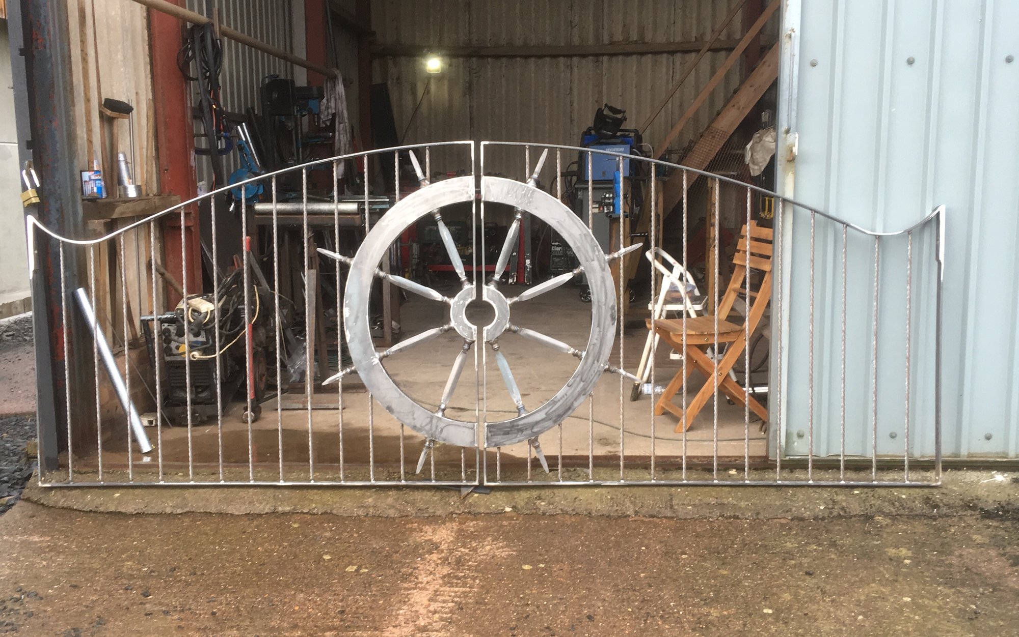

Only thing that niggles me is the two missing uprights above the wheel.
Looks nice but make sure you Anchor the posts well.
I’ve done two sets of gates in the same area, one powder coated and one galvanised and the powder coated one still looks like newIf they going by the sea side, id take them to Birtley and have them galvanized first
The gaps at the top take a lock and catch that closes the gapVery tidy again.
You can if your 350mm tallCn you not just step through the gaps in the ships wheel?
I guess they're primarily to stop vehicles?

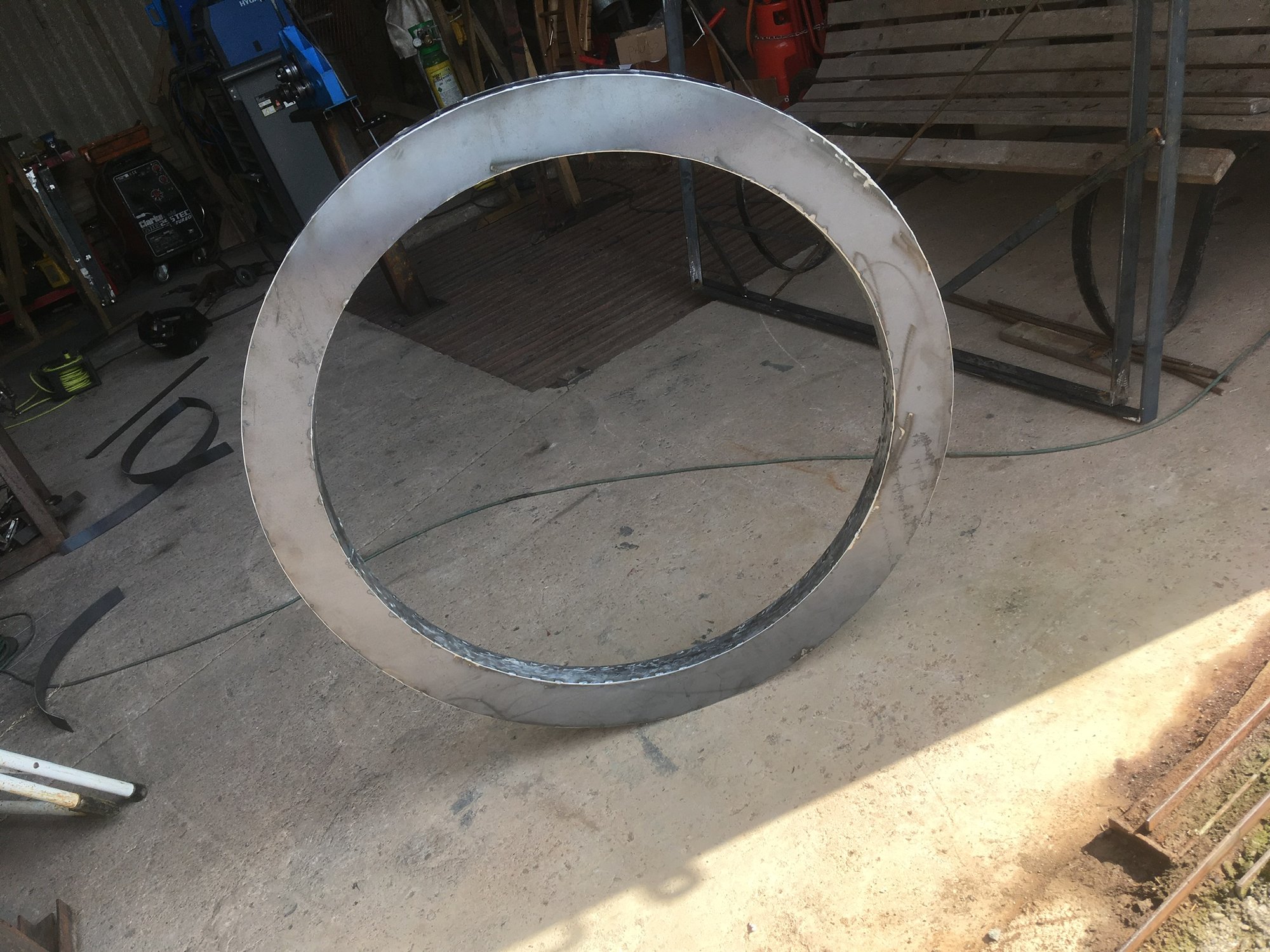

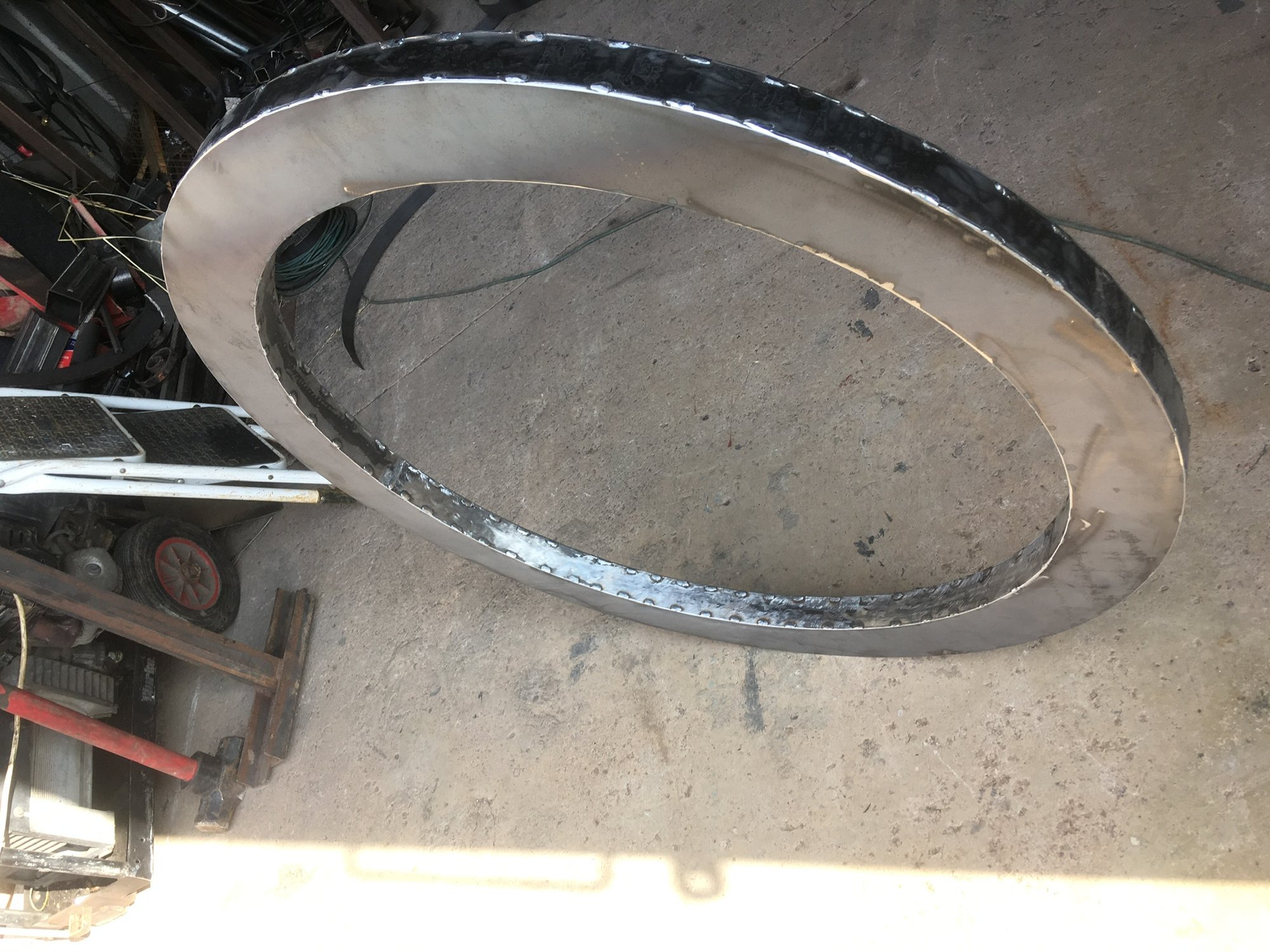

Yes. Plasma cut the rims from 3mm plate and rolled 40x3 flat to give it some depthLooks neat, did you make the wheel too?
I Sea what you did there.
I wonder how many moor puns we're going get!
