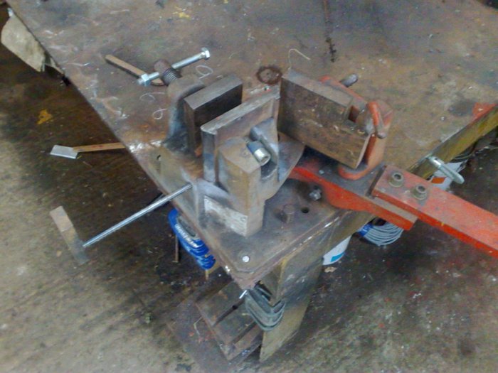

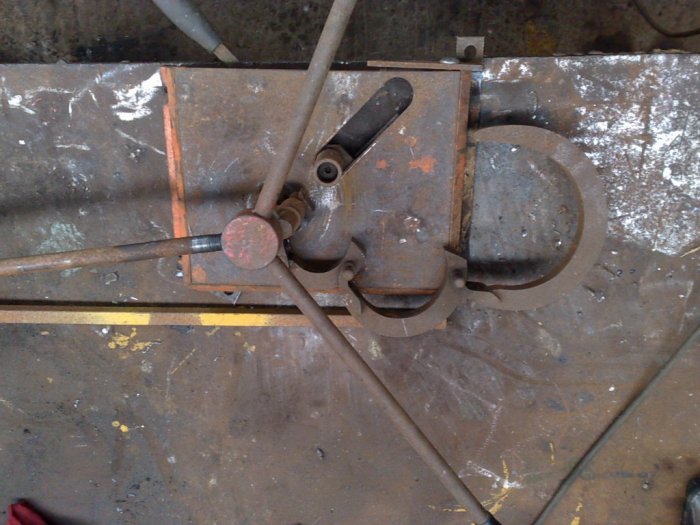

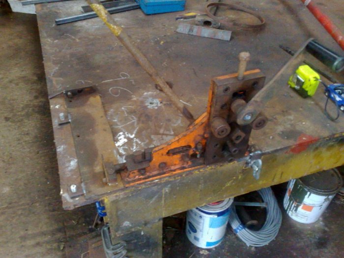

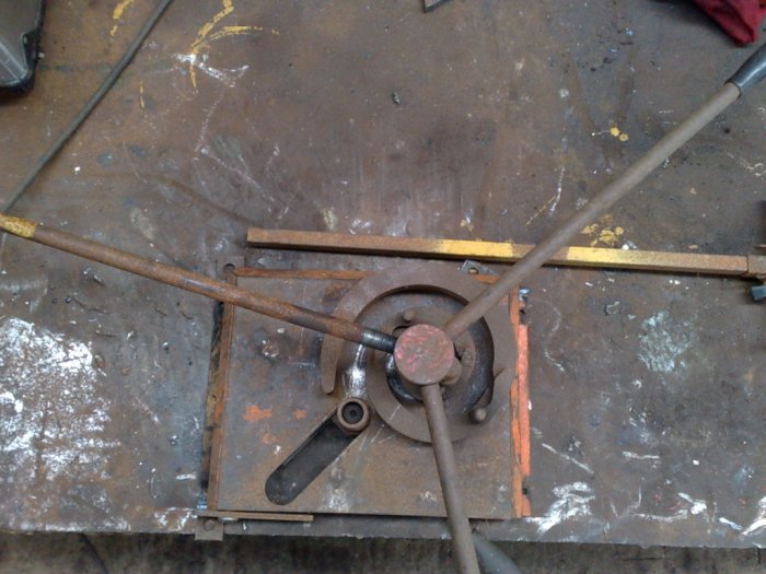

I bought this one about 10 years ago and it has made at least 1000 scrolls.
Hope the pics help.
Ah..Ha...ghound I recognise this, it's from a company called Metalcraft in Hull, and am just in the process of buying there master workshop....
Sean
A 'handy wee tool'
A bit of understatement there!
" Shearing : 25mm x 5mm (flat strip), 6mm (square bar), 6mm (round bar/wire)
Punching : 5mm diameter hole in up to 5mm thick material, 3mm diameter hole in up to 3mm thick material, 6mm diameter hole in up to 3mm thick
Riveting - 5mm diameter rivet
Bending - 25mm x 5mm (flat strip), 10mm round, 10mm square bar. Angle of Bend Achievable - 180° to 60°
Rolling - 25mm x 6mm or 30mm x 5mm flat strip, 10mm round, 10mm square bar
