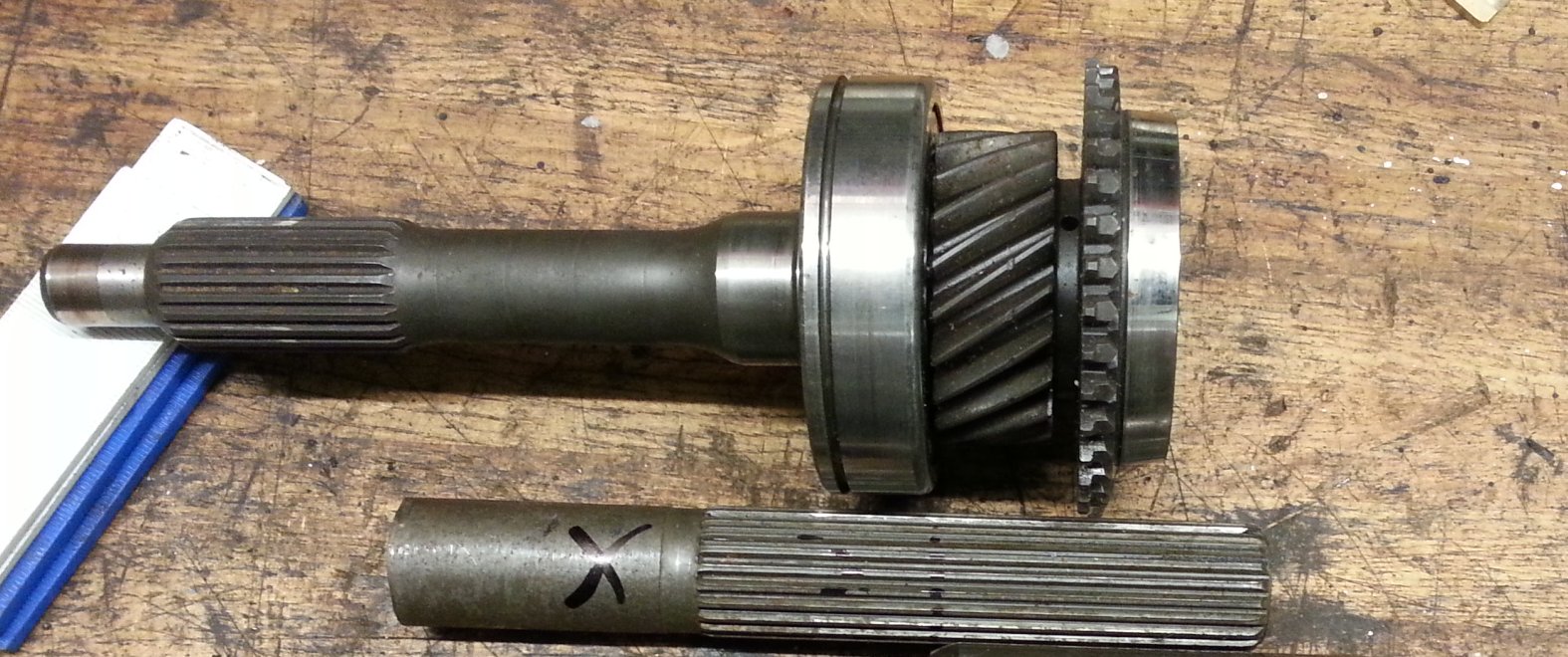

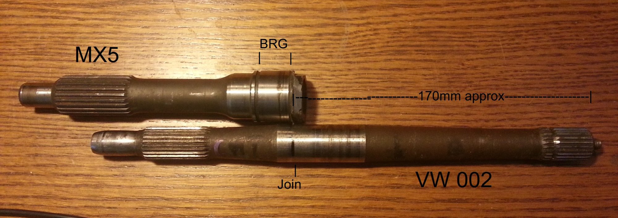

As I am still waiting for the template to arrive I have turned my attention to the shafts. Only to find once again that my plans for welding are thwarted by heat distortion. The plan was to join these two MX5 bits
Like this (chopping the cogs off)
and this VW and MX5 female spline bit
like this
So that they could handily slide together during assembly of frankenbox like this
Unfortunately it would appear that as I want to use the splines they can't be machined after welding so would not run true.

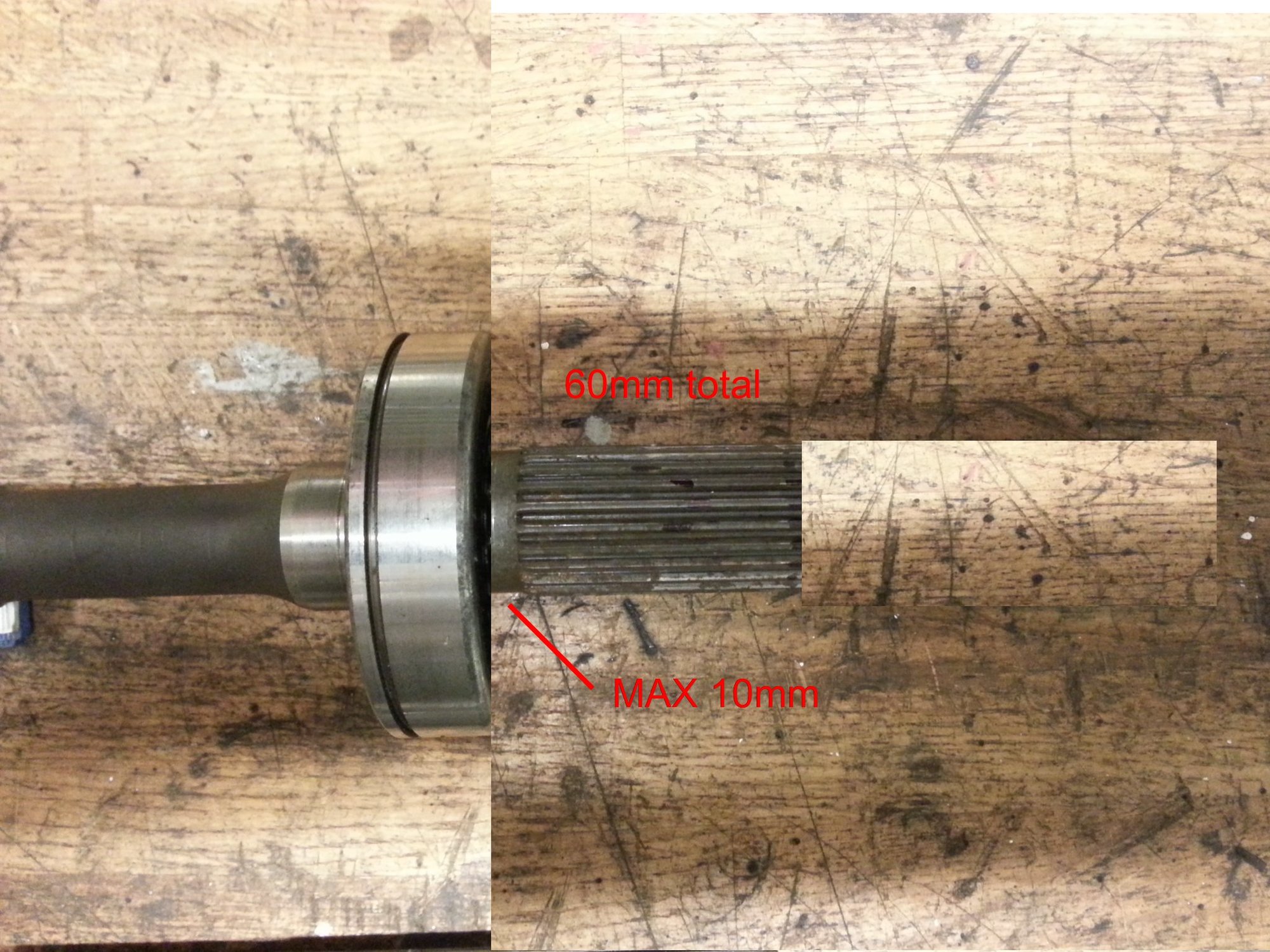

Plan B is to drill the MX5 shaft under the bearing and reduce the male spline to fit and roll pin - not very happy with that as it means the shaft will have to be taken down to about 15mm with a hard shoulder. The VW shaft would get the same treatment except it would need to be sleeved then the female spline roll pinned to it.

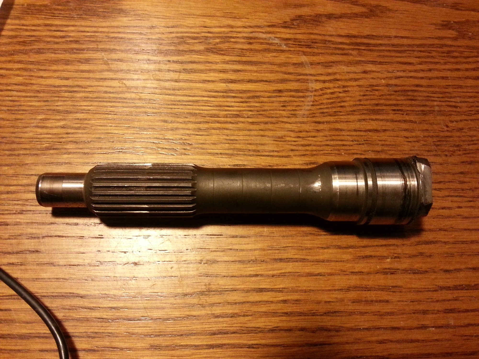

The cogs on the end of the MX5 bit looked like they were pressed on - but they certainly were not coming off with my 6T press so I chopped them off with the angle grinder (only about 10mm of shaft in the centre) so I could get access to the bearing which pressed off easily. Now frustrated by not having a lathe as I could do all this myself!
Question, now I have chopped the cogs off and pressed off the bearing I have this
Diameter of the bearing mount part on the left is 30mm, What size should I have this drilled out to to fit and pin the splined shaft? 15mm as it is half the diameter or 21mm as that is half the surface area or something else..

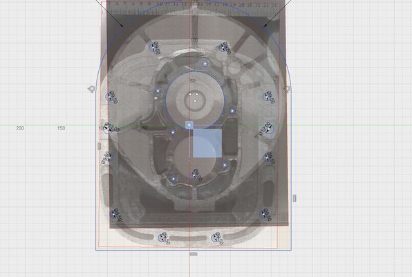

Well the good news is that my laser cut template fits like a.. well, like a laser cut template. Seriously though, the two 12mm holes fit over the two 11.99mm dowels - the positions of which were determined from the scan. These determine the centre of the bearing that holds the engine output shaft so not much tolerance allowed.
The bad news is that it took a loooong time to get the template and now I am still waiting on a price for the 2 real Ali plates.

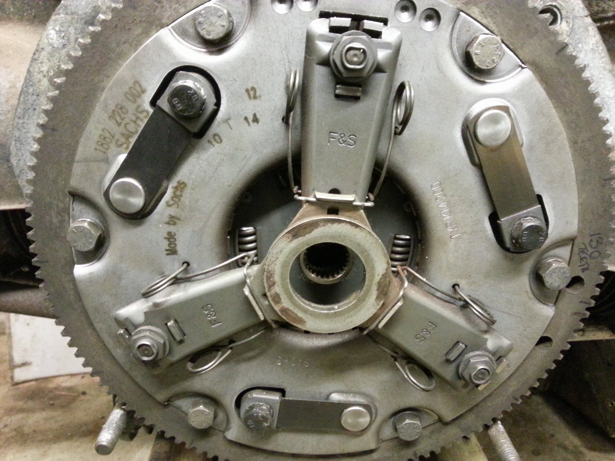

Talking of bell housings the VW one I have is for the old style throw out bearing that requires a central push plate on the basket like this
Unfortunately swapping to the later style that can work with the fingers of an MX5 basket is not easy as the bearing is different, but so is the mechanism and the arm diameter and, and... Upshot is I need a new later VW bell housing.

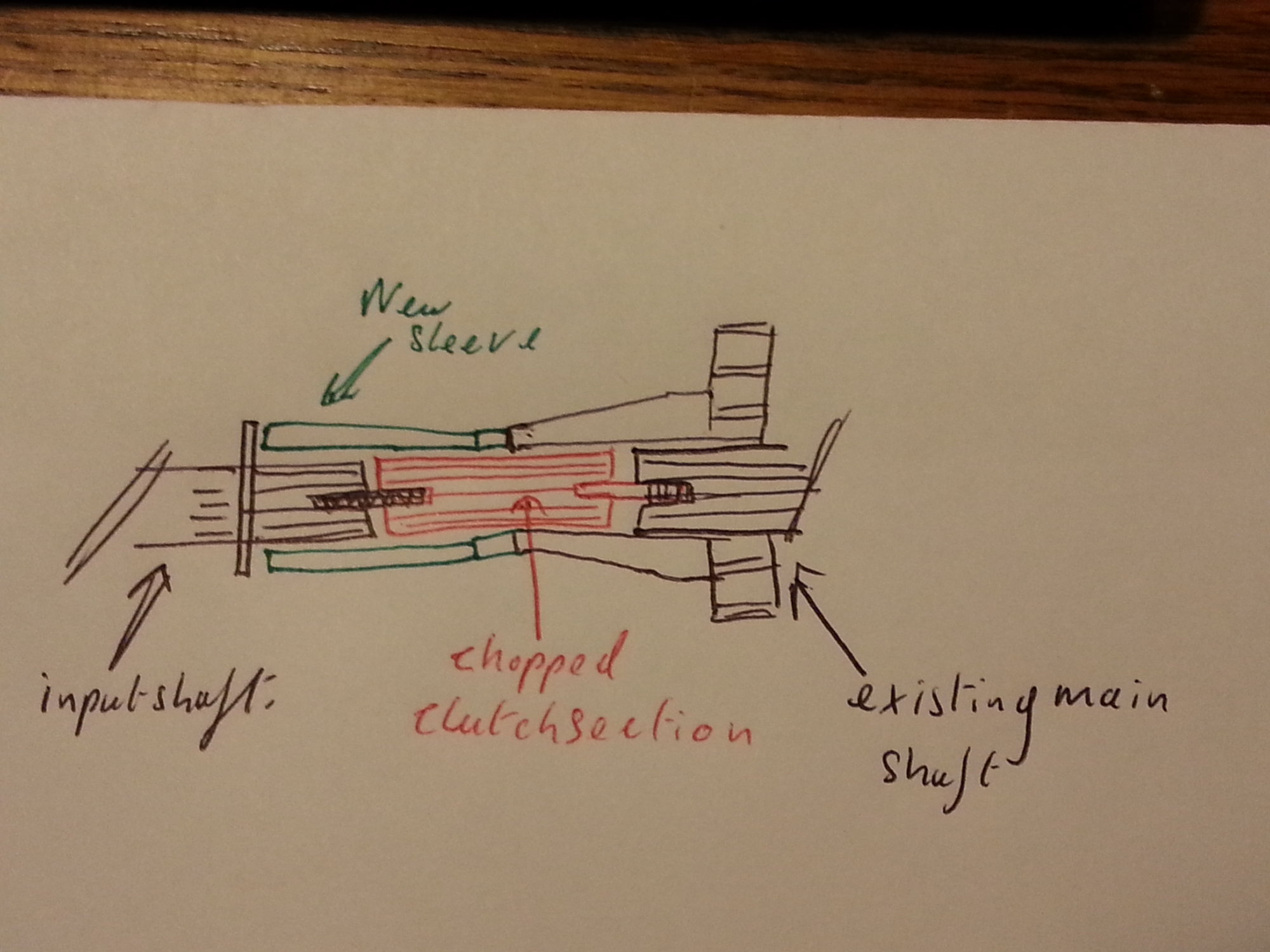

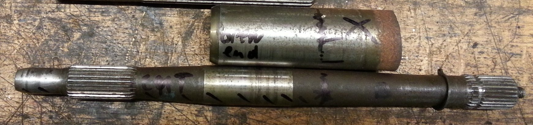

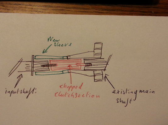

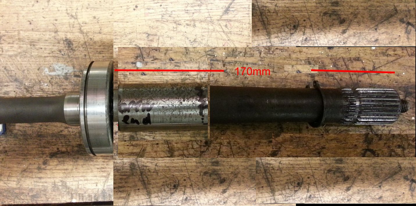

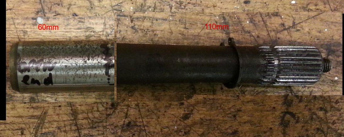

Had a shaft brainwave and finally .. a Plan! to use the MX5 part case and plates that I have designed
I can extend the shaft by using a splined sleeve off another gearbox and a chunk of clutch spline cut off another shaft. Actually I will buy a 298mm shaft and chop up the one I have. All VW parts and a splined sleeve is how the input shaft joins the main shaft as standard.
Like this (back of an envelope design)
This handily locates the smooth section of VW shaft at the intermediate MX5 bearing and seal so I will have a close fitting bush made up (I must get a lathe!) so that I can mount the MX5 bearing on it and the standard oil seal - duplicating the MX5 shaft at that point, probably with a bit of Loctite 638 to hold it in place.
