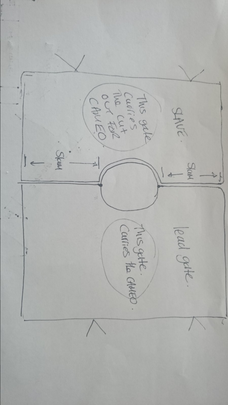

The whole job is a set of railing which are already done and then a double gate to fit a 2m space. I dont have a lot of experience making gates so have taken this project slower than usual.

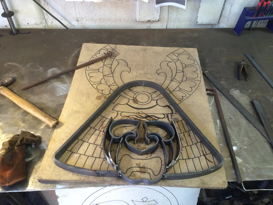

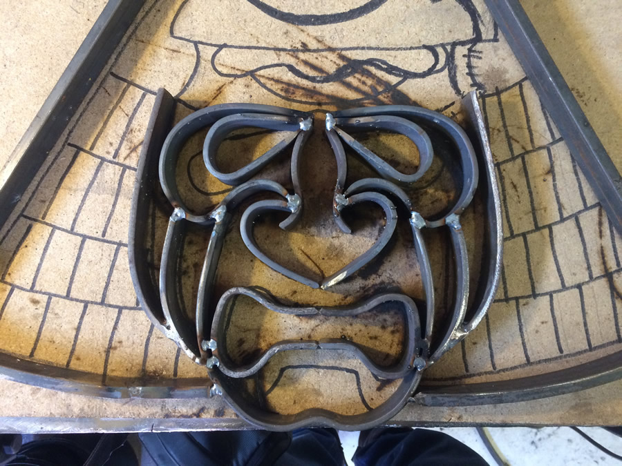

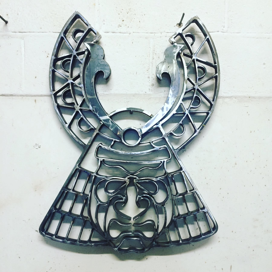

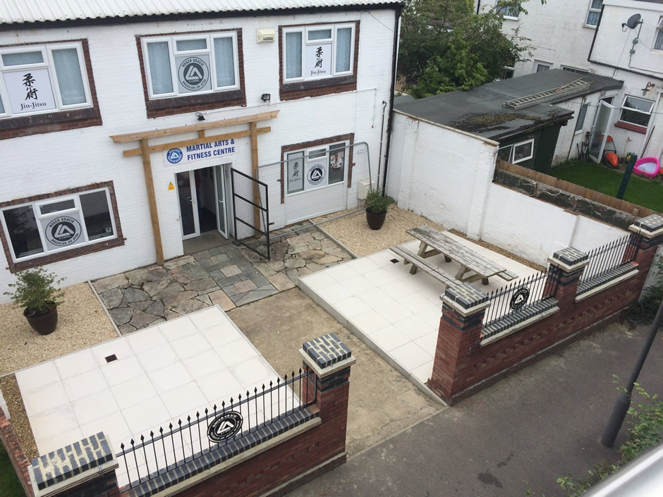

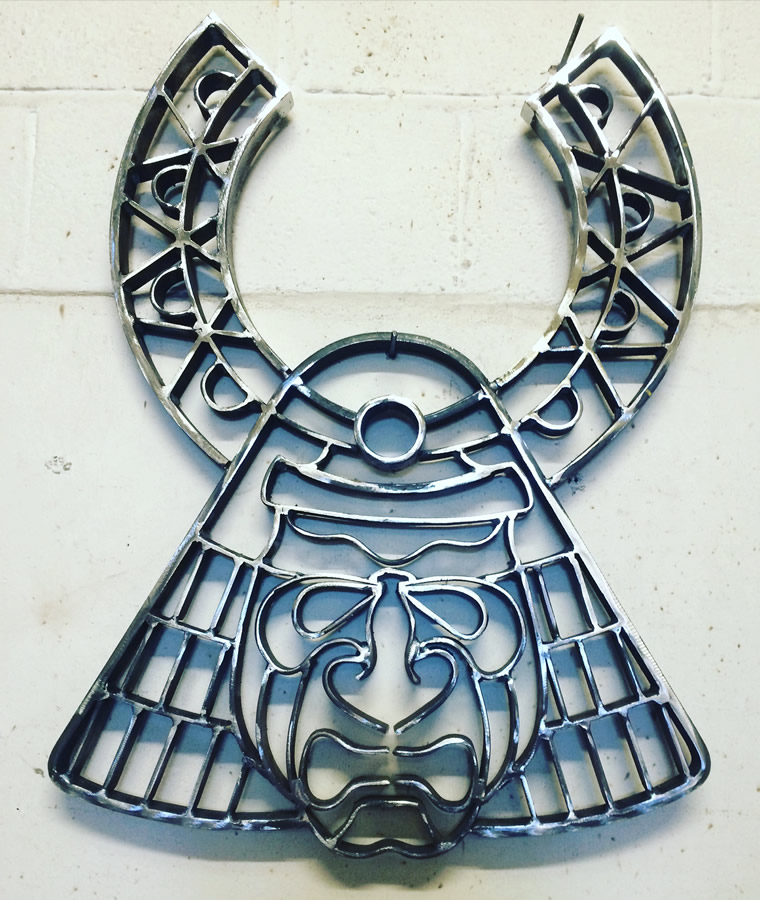

So to add the setting, the work will all be done between a small walkway and the yard of the martail arts acadamy, I wasnt sure how I'd make the samurai because I wanted it to be seen from the club and the pathway behind it. Eventually I decided to use 30x10 flat bar for the outer line and 30x5 for the inside design so that it can be seen properly from both which ever side you are.
I've just finished the mask and will now start trying to figure out the gate bit...

The view from the bridge above the pathway

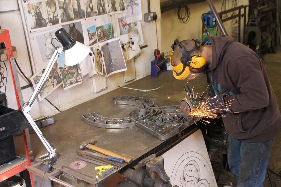

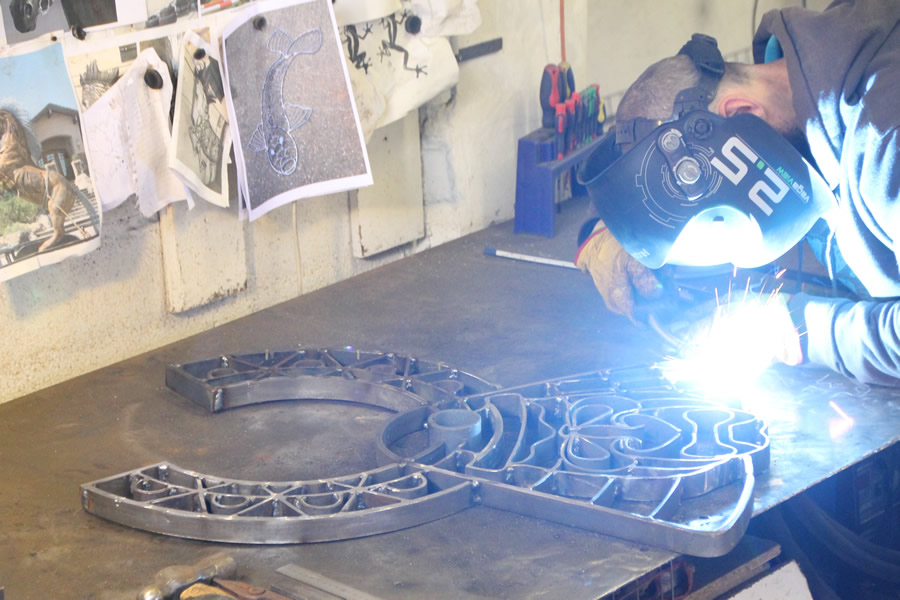

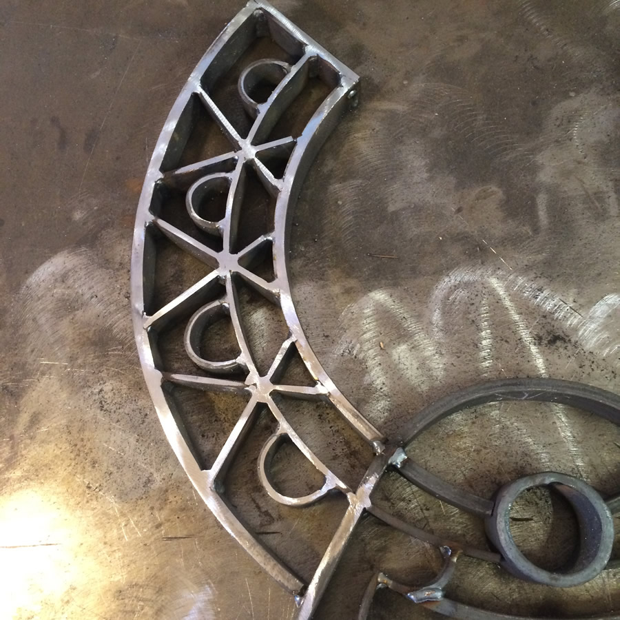

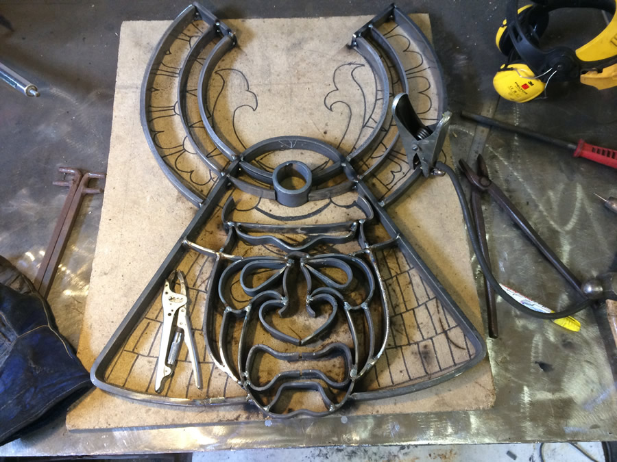

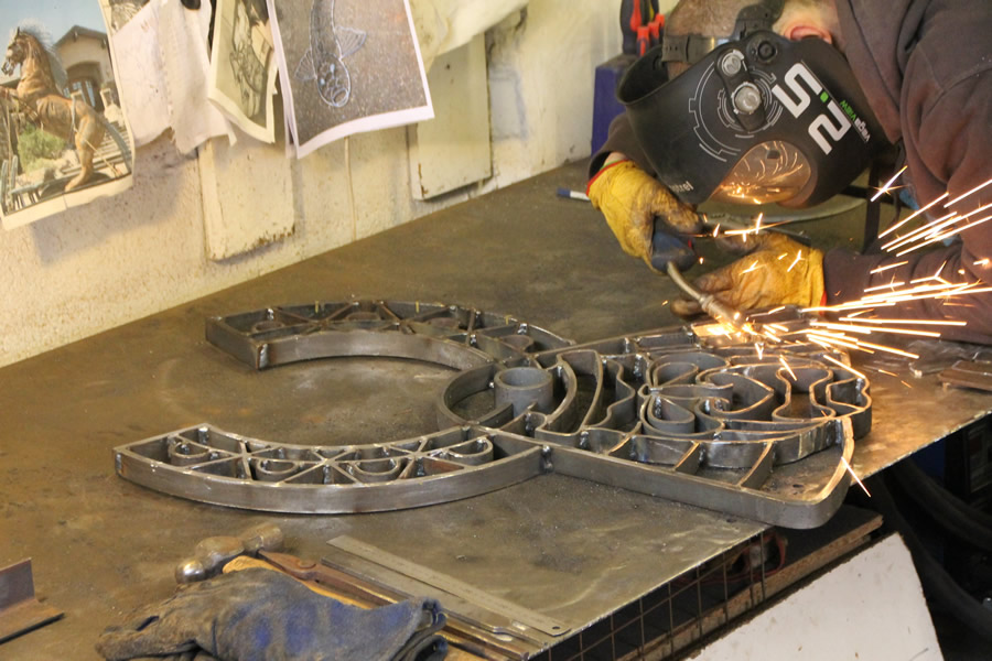

Using the wood to draw the image I then started to bend the steel. I uses a forge to get the tighter bends and to tapper the steel so it went together better
I will be splitting the mask in half and then add each half to each side of the gate
