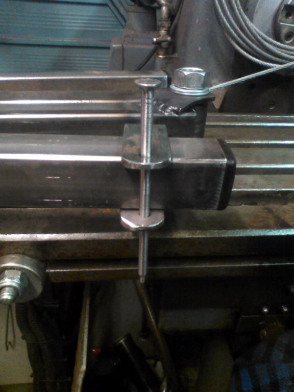

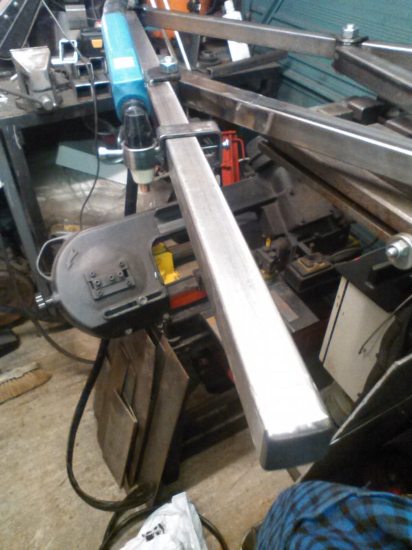

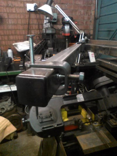

Still a lot to do with it and not a perfect design. There are two 21 mm by 12 mm internal hole bearings in each of the four pivots. Still have to get two thrust bearings for the central fixed pint. The maximum reach is 550 mm or thereabouts. It will not open any more then in the top picture due to a design feature. I should be able to change that a bit. Plan to have two plasma holders on one leg and two pointers/follower positions on the other, idea being I could either due 2:1 reduction, 1:1 copy or 1:2 enlargement if it all works.
That's the plan anyway.
Adrian
