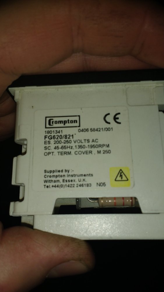

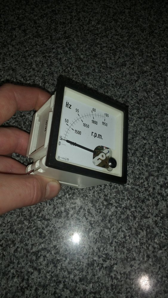

A bit of an aside, (but I am getting closer to starting):
As an avid collector of tat I picked this rpm/frequency meter up years ago out of some other kit going in the bin. Up to 1950rpm and 65Hz.
Thinking of adding it as a bit of bling. Just two 1/4" spade connectors on the back, one marked +.
How does it wire in?
But since you are running from the mains supply fitting that meter will be a waste of time as you will always get 50 Hz!
