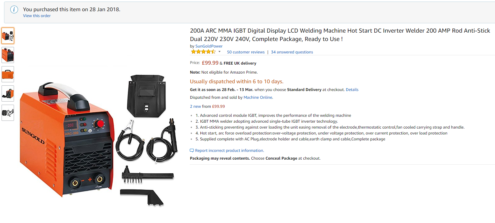

So I had a hankering for a cheap arc welder that I could take almost anywhere - it had to be an inverter, cos I've been spoiled, so I spent some time hovering around the used ads but couldn't find anything less than £100 until I spotted these on Amazon: Sungold 200A inverter stick welder, at £99.
Reviews were mixed, and there seemed to be some serious concerns at whether the plug was wired correctly, but what sold it to me was an Amazon cosmetic refurbished unit at £92 delivered, so with the full Amazon warranty.

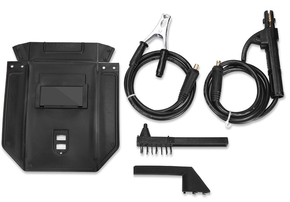

It came with a mask and hammer, which need to be thrown straight in the bin, as well as a stinger and ground clamp:
Turns out these are mini-dinse so I can't use the R Tech leads directly. The ground clamp is a bit pants but overall, they're not the worst.

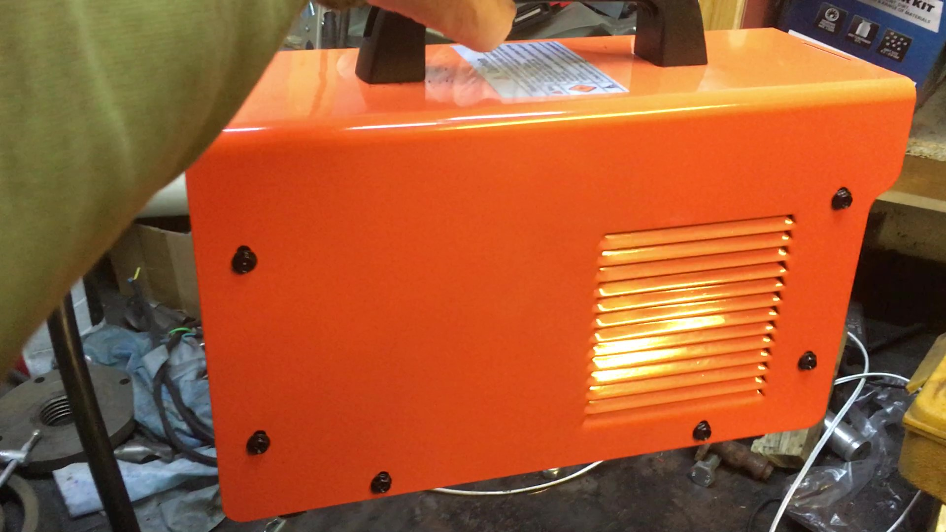

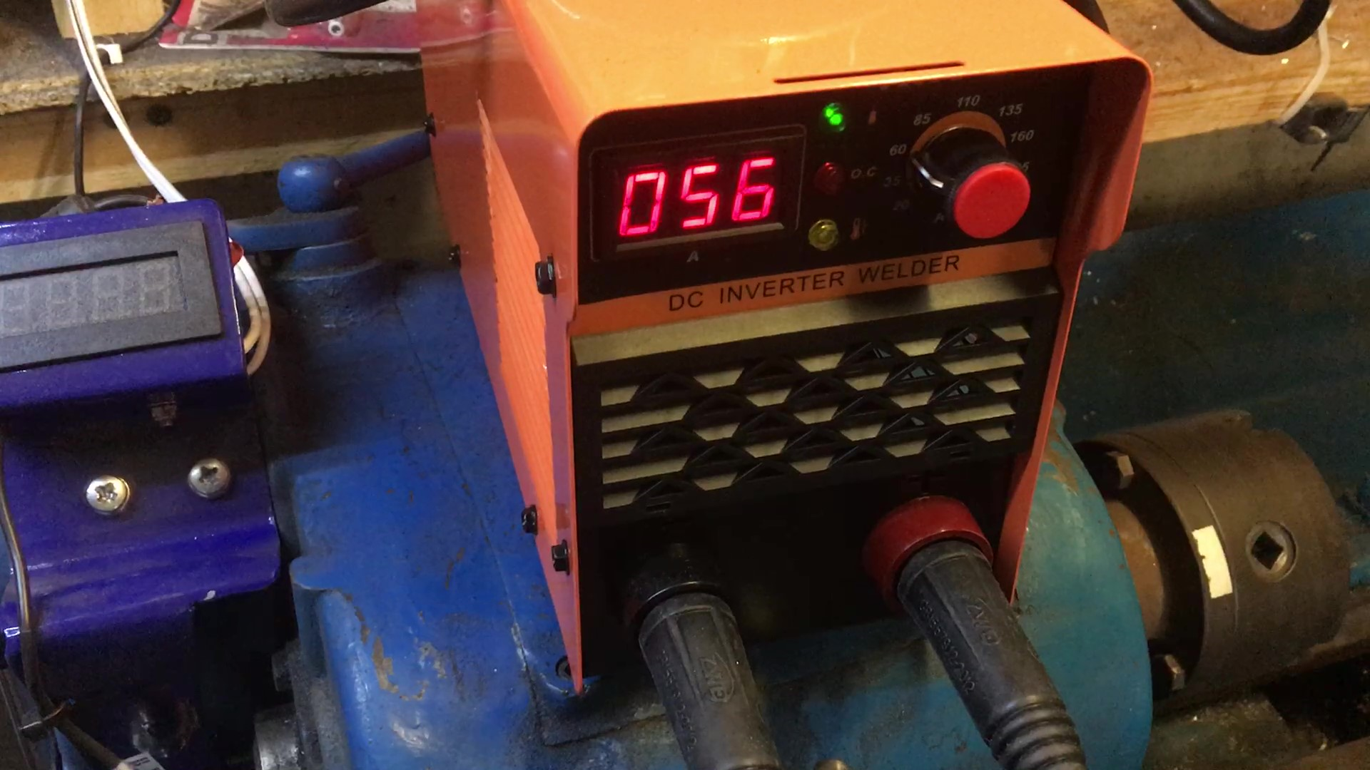

It's very dinky, only weighing 3.5KG:

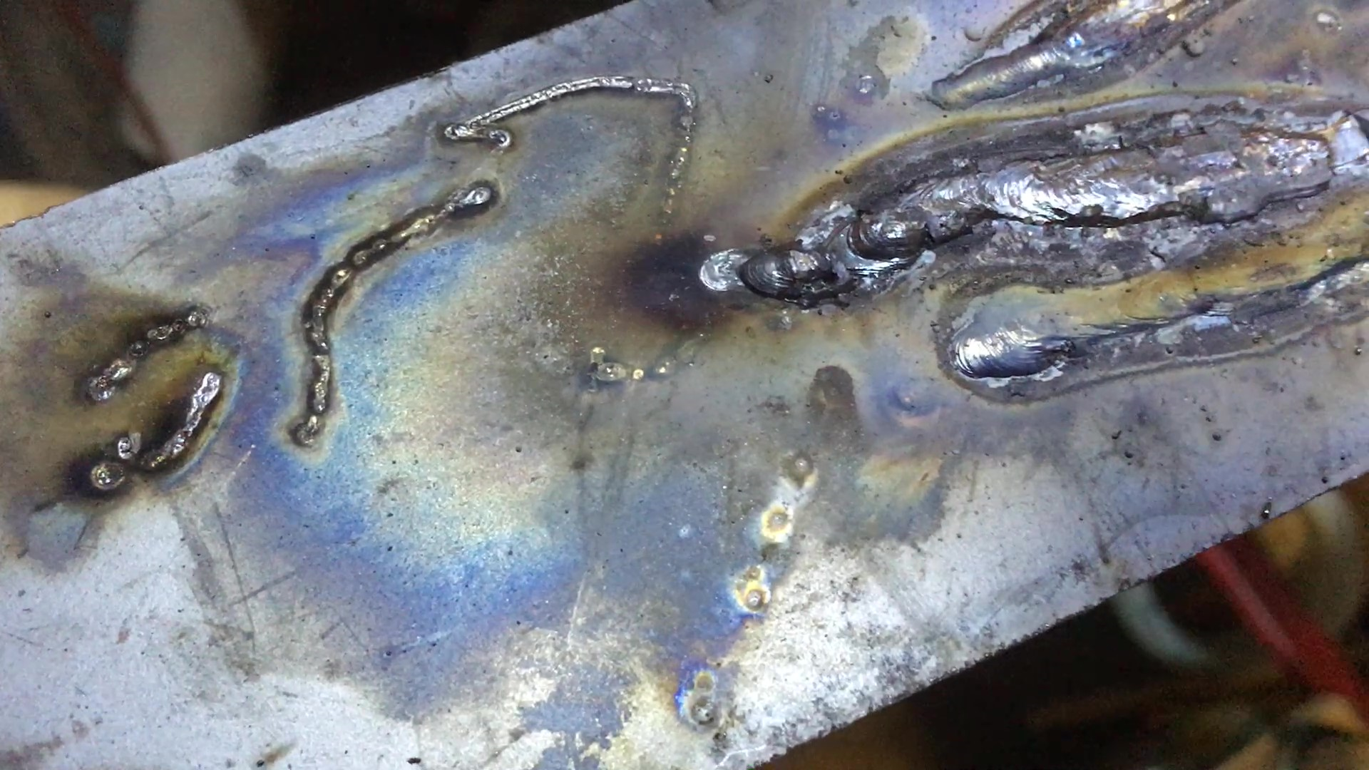

Started out with some GYS 2mm 6013s on 3mm steel - set it to an indicated 56A but no good - just spat at the metal. I dialled it up to an indicated 85A and all seemed good.
These are the welds it produced. Please don't feel the need to comment on my lack of stick-welding ability - I knows it
The ones on the left were the 2mm at indicated 56A. The three on the right are:
Underneath view - again, 2mm on 6013 on the outer two and 3.2mm on the middle one:

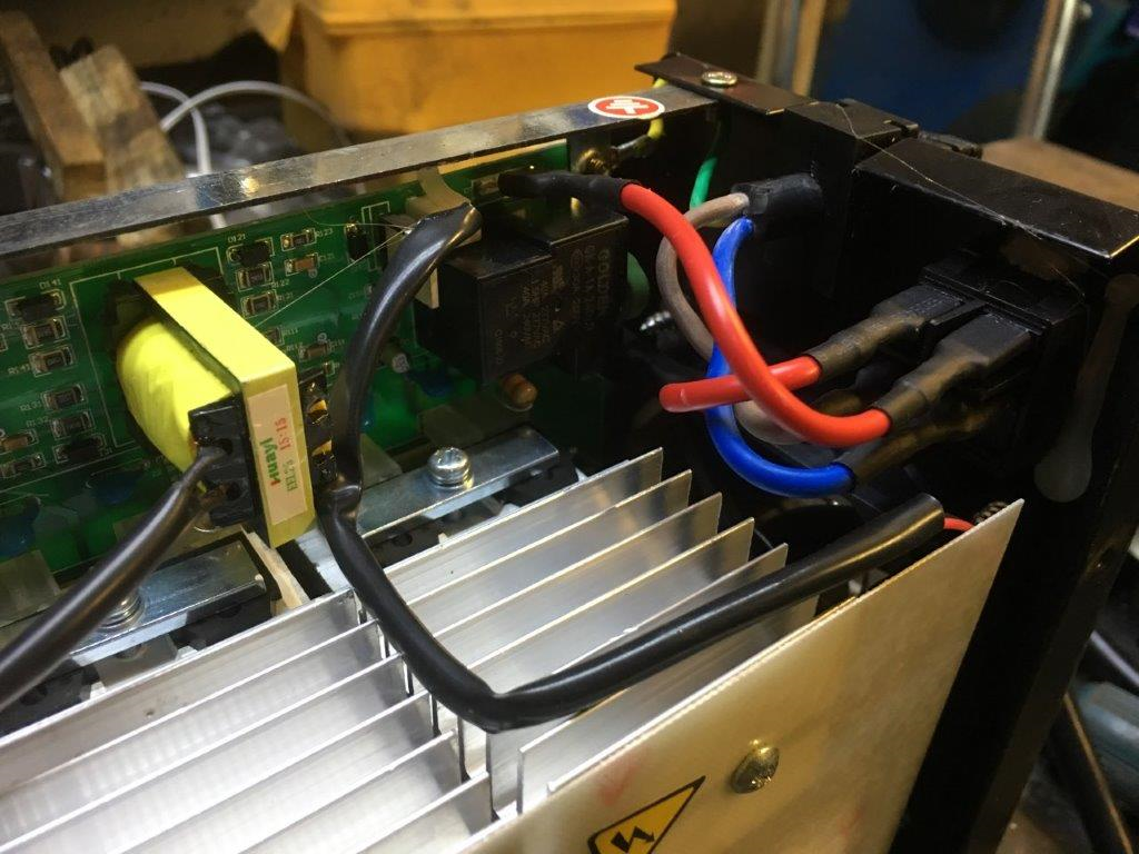

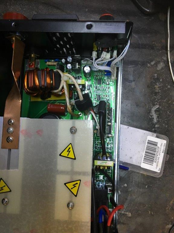

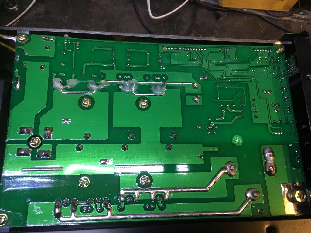

Some internal shots which show that (lack of fuse notwithstanding) it's surprisingly well put together:
All in all, I'm pleasantly surprised. For the money it seems well put together and does a decent job (though I doubt it would get all the way up to 200A, or stay there for very long!).
Top and bottom: 2mm at indicated 85A
Middle: 3.2mm at indicated 117A
