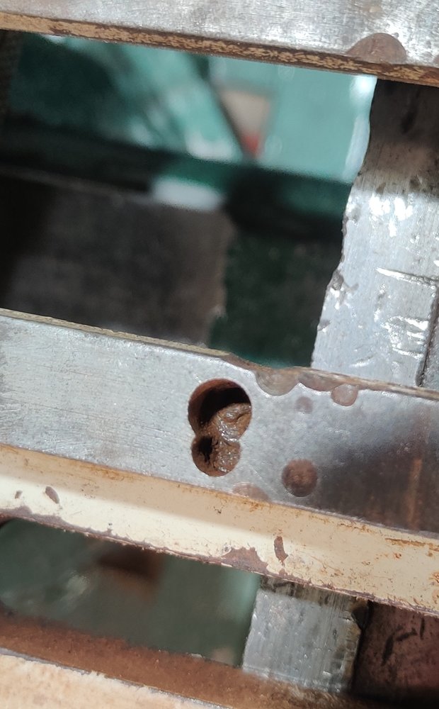

when you tap it and screw it in make it a fraction longer sticking up then peen it over with a ball pein hammer and grind it back flush . it should completely fill in the hole and not be seenWow. Thanks for all the thoughts!
I think I'll start out by tapping the hole as part of the exercise is prettifying the vice and I think by tapping I can make it pretty close to invisible . Not sure that I'll be able to do that with JB Weld even if it functions the same.
I'll post results once I've finished.
Thanks once more
Ah of course! Wish I had read this. Here is a video of a hole I filled yesterday which didn't end up invisiblewhen you tap it and screw it in make it a fraction longer sticking up then peen it over with a ball pein hammer and grind it back flush . it should completely fill in the hole and not be seen
Yeah sorry. Its my first video. I think it's visible now.You need to change the setting to make the video viewable.

Looks much betterHere are the two final holes filled. I didn't manage to make them invisible as I concerned about damaging the vice if I peened the repair plugs too hard however as with the repair of the hole in the jaw I think it looks better.
I've included pictures of the finished restoration and the initial condition for interest.

How far out are the holes? A clash wouldnt be goodHello fellow hole fillers.
I did not want to make a seperate thread for my question .
I am restoring an 80 year old vise and the jaws were beyong saving.
So I bought new ones from a Bahco vise and the dimensions are perfect.
The screw holes dont align with the old ones ( i did know that beforehand)
My idea was to 2K epoxy glue screws in the old holes , cut the screws flush and try to drill new holes and tap them.
Would that be an adequate repair?
