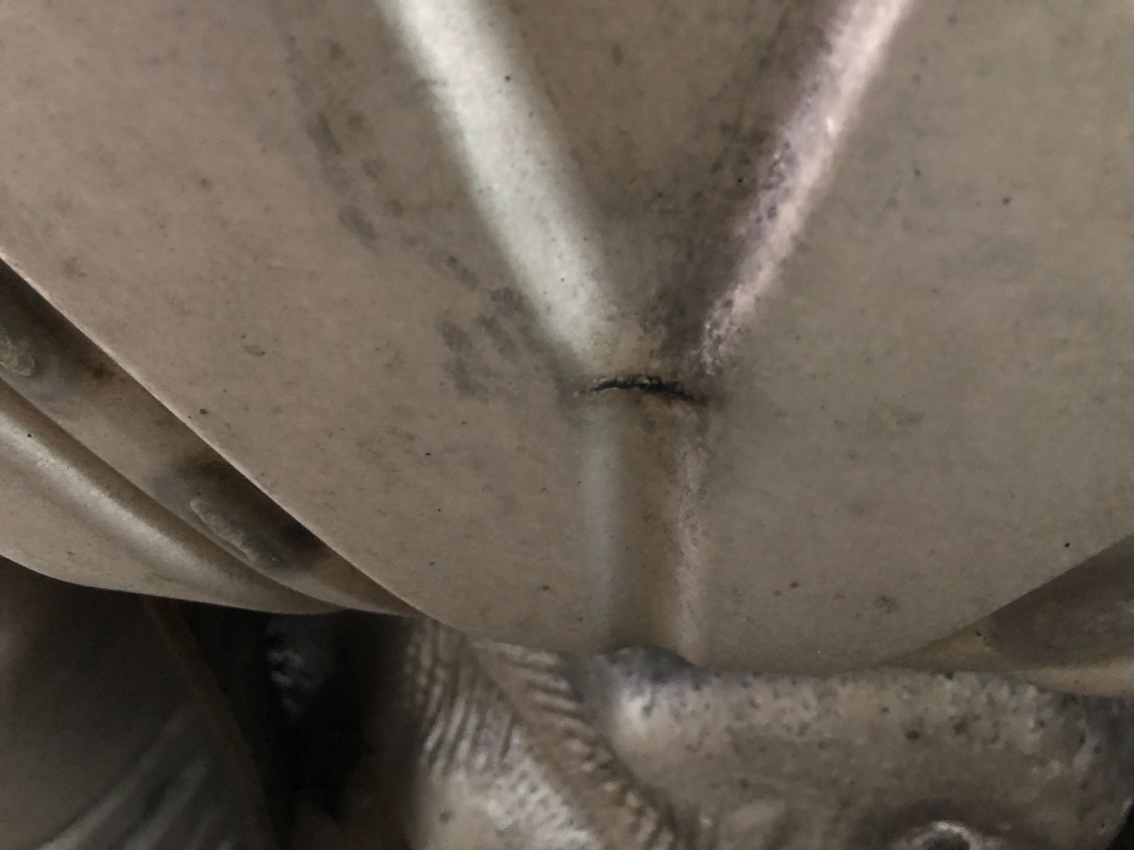

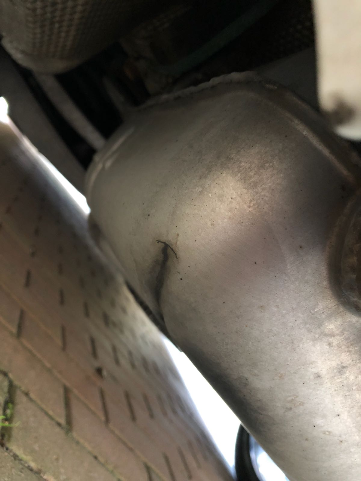

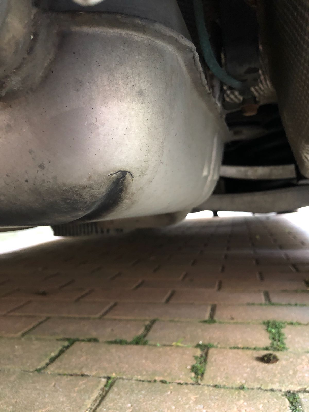

    I have a friend with a few small cracks in his bmw inconel exhaust. He is looking for someone to repair it for him and my tig box is still virtually unused so my skills are not up to it
    from research it appears to need inconel filler rods (625 or 718 not sure) although one person has offered to do it with stainless filler which sounds wrong to me
    If anyone, preferably herts/beds area, is interested in taking this on as a paying job then please contact me and can either put you in touch or work as a go between
    the box would be removed from the car so it could be done on the bench and delivered/collected although it looks to be a biggish lump judging from the size of the pavers

    Are you sure it's inconel? Seems strange to me to use an exotic material on a muffler. Headers yes, especially if on a motorbike.

    First picture shows its had a couple of repairs before, its probably rotting away from the inside, I don't know what BMW exhausts are made of but if it is an inconel will not be easy to weld with all that soot on the inside, its mucky enough stuff to weld when its clean new material, a patch might be easier than trying to weld the crack, and no that's not an offer, I don't do cars.

    I agree entirely with paul. It's best to patch that with some thin sheet of the same material.
    Your right stainless filler is not correct for welding on inconnel. I would guess 625. Someone might have a spool of 0.8 solid you could take a couple of loops off.

    Was thinking the same, looks more like aluminized steel.

    I thought Inconel didn't rot ? That looks like an aluminised mild exhaust to me as well.
  9. They were a costly optional extra. 625 is what you want. Or ring Eisenmann for a replacement.
    Having welded 2 exhausts previously, and almost killing myself in the process, it's not an offer..
    Looks like it's been opened up and repaired previously, so a replacement would probably be the better option..

    as others have said, looks like aluminised mild steel, might be worth a try with a mig first.:scared:

    does anyone know if inconel is magnetic? just in case that is an easy test of the material
  13. Richard.
    Richard. Member
    Messages:
    12,735
    Location:
    Cambridgeshire
    It's not magnetic.

    Well considering if you look on the internet these exhaust systems don't seem exactly robust I would advise replace with the standard M3 exhaust system or get a custom stainless system made up.
    Anyway it only looks like the rear box has gone so just replace that - couple of KG added back on to a modern M3 you will never notice the weight difference.
