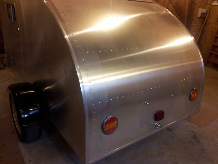

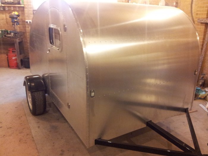

Andy how long do you think it will take to polish it? I am just finishing my aluminium teardrop its tiny in comparison! its just standard mill finish. I would love to polish it but dont think I dare start something I couldnt finish...so was going to just leave mill finish...
great work striker i could be tempted to build one of those myself, as for airstream im not sure how long it will take as its 25ft long but from what im reading on american sites maybe around 150 - 200 hours for a mirror finish although one guy says allow 20 hours per ft
from what ive read this is still with handheld polishing machines it takes this long still, i have various polishing tools plenty of mops compounds etc so im hoping to get it done a lot faster
