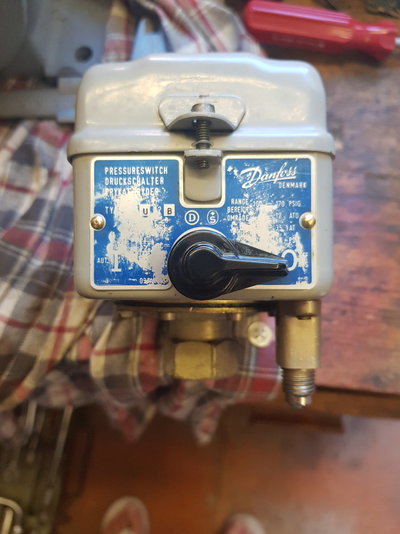

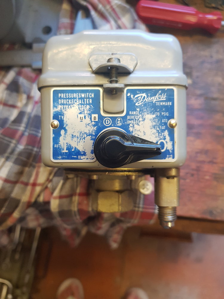

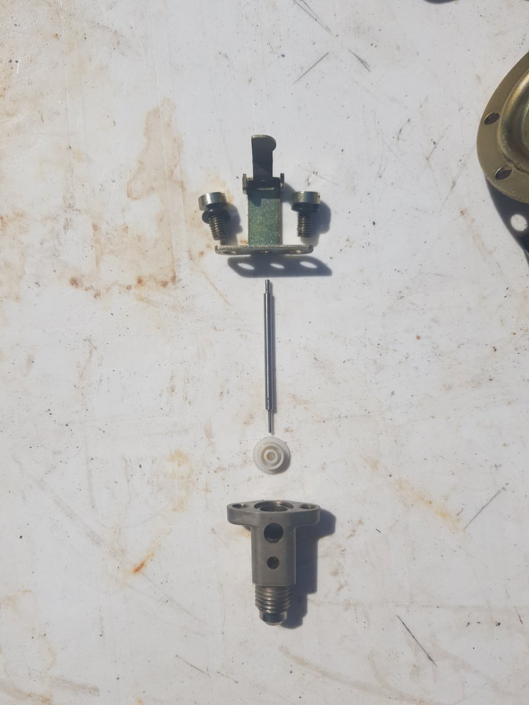

Some do, some don't. The type fitted to Bambis don't whereas the type fitted to cheap direct drive compressors do. Which is why they state that you should only switch the compressor off using the red button, and never from the main switch.
The giveaway is if there is a small air line running to the switch from the outlet side of the pump head. If there is it's a mechanical unloader type.
