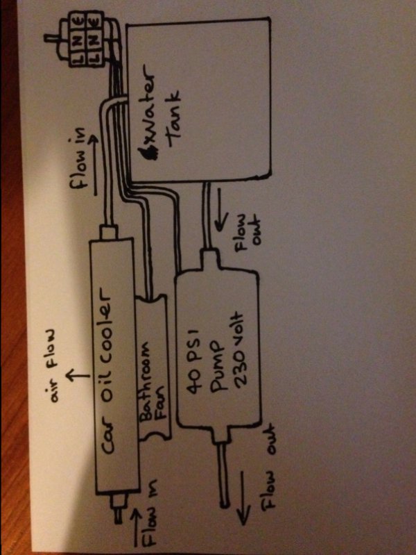

If you struggle let me know. I could use another little project. Coolers are easy. I'll put up a sketch to show you how I make em.You interested in making me a cooler in the future Richard
Feel free to give me a price.
Forgot to mention the most important part, make sure your live terminals are well sealed up should you spring a leak inside. I mount the terminal block inside a small sealed box to protect it from any water

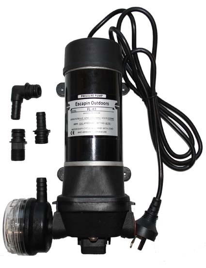

Aquarium pumps are total useless no where near enough pressure to get round a Tig torch. Last one I did I used a 36psi shower pump and it was terrific. I've never personally used a CH pump but I've heard mixed reviews on them some success some not enough pressure.
http://www.ebay.co.uk/itm/Shower-Pu..._Bathroom_Shower_Units_PP&hash=item3f446c1cc1I'll make one for you pm sent mate.
These are ok but I prefer to keep it simpler with single entry/exit inline type. This should not put people off using the double type though as they work very well you just need a couple of T peices.
