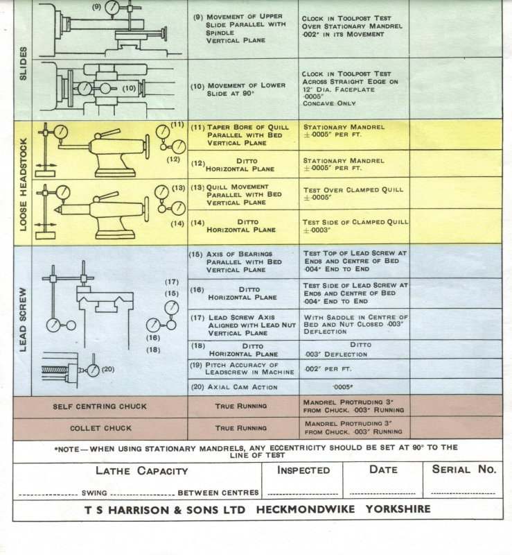

I`ll second everyone's comments on NOT removing the Bed from the Base, Harrison went to great lengths to join the two together. A really nice machine will come with the original test certificate from the Harrison assembly / final inspection with measurements and checks you may be able replicate. But be unable to adjust. So even if it doesnt have its certificate leave the Bed and Base well alone.
Here`s some Harrison checks you can do.
