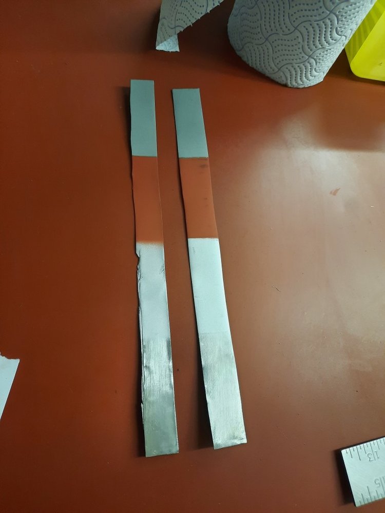

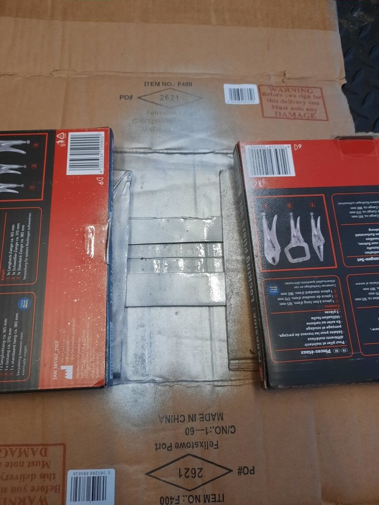

The First Test
Each strip was painted up using a high tech mask of card and some parkside mole grip boxes to weigh it down

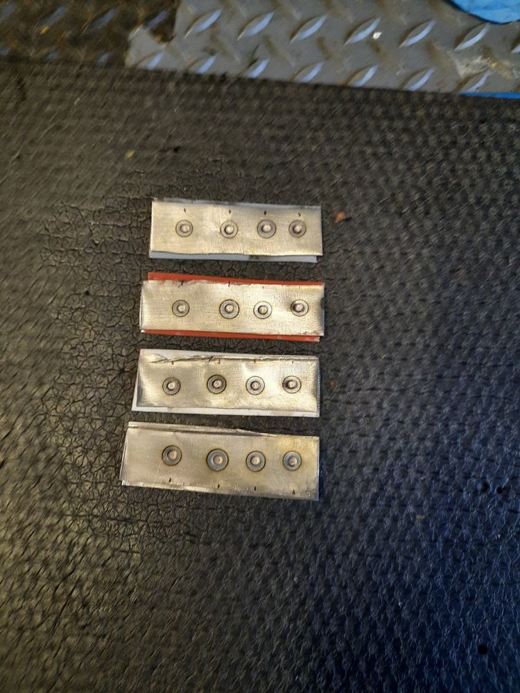

The finished strips, prior to cutting. Electrox at the top (dark grey), then Bonda Rust Primer (red), then Frost Weld Thru Zinc Primer (light grey), lastly phosphated steel at the bottom.
The other side of these was not painted. Having paint on the outside of a seam will hinder the resistance spot welder from starting the weld.

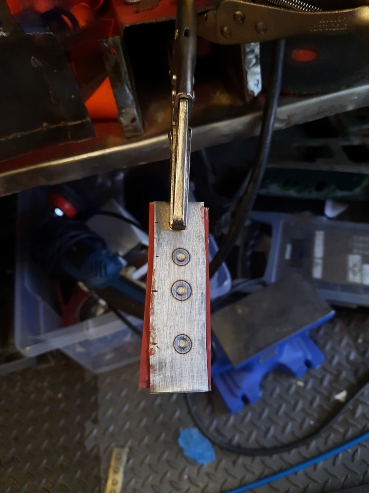

Each piece was then spot welded like so:
Until all had been done.
First test result
I'm pleased to say that all the products appeared to work well in this manner. I already knew the Frost weld thru primer would do the job well as I've been using it, but all 4 pairs of steel seemed to give really good, strong welds. There was no visual difference in the heat affected zone outside the panels, and they were all as tough as each other to separate. Sparking from the welds was about the same for all of them.

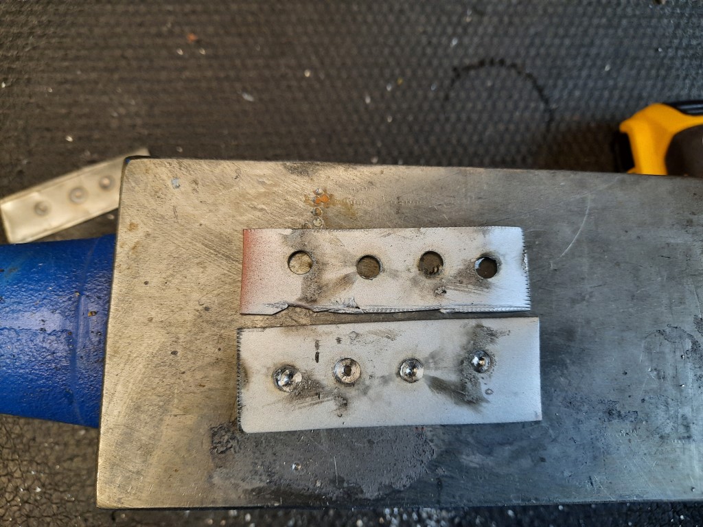

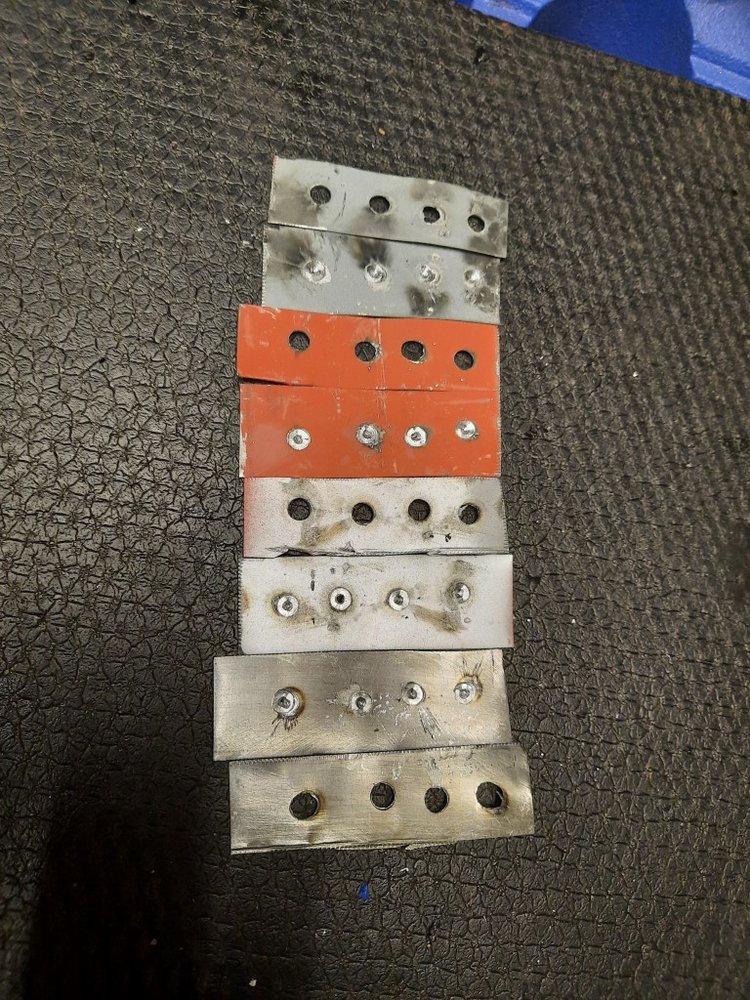

The next step for the first test was drilling out the welds to reveal the inside.

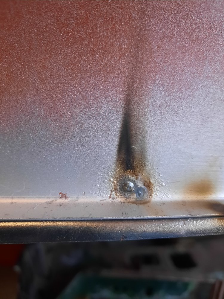

1) Bilt Hamber Electrox. This had the most scorched appearance, though appears to be an intact coating where it exhibts the scorching. The two welds on the right seemed to lose a bit of coating but I'm not sure if that was just from when I separated the welds. This one seems the easiest primer to scratch through mishandling.

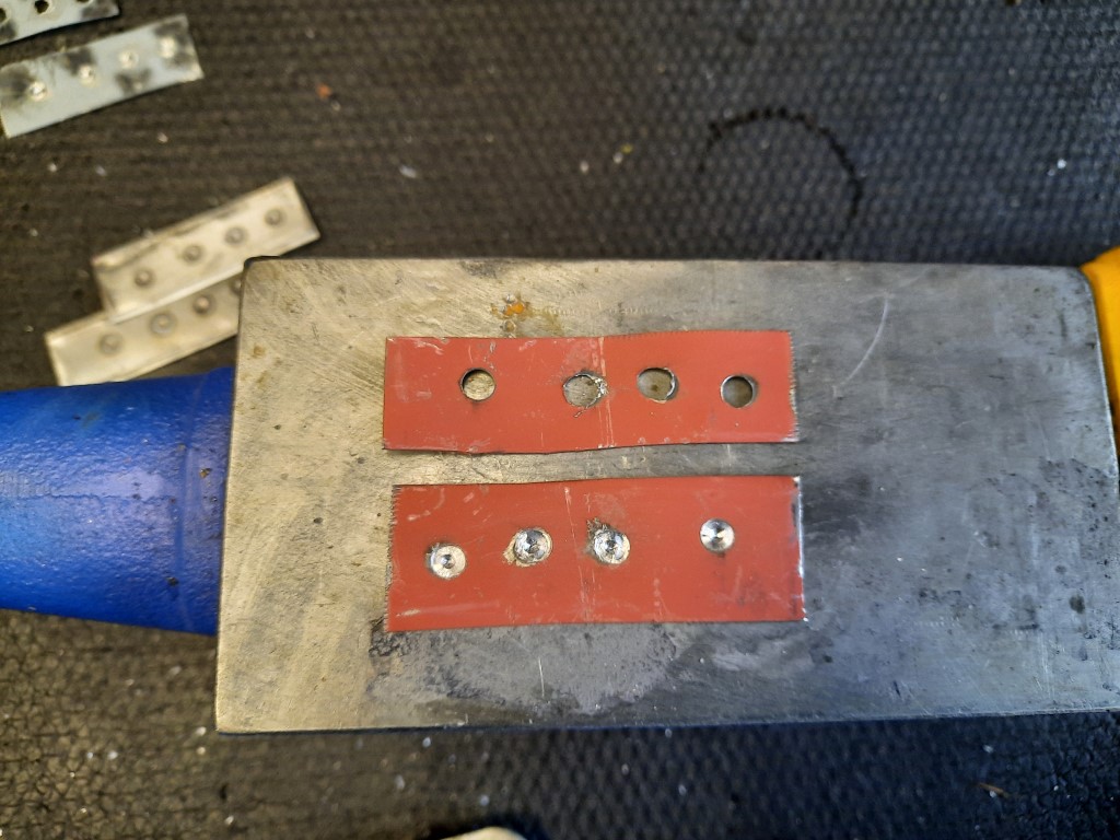

2) Bonda Rust Primer. I would say of all of them, this has the neatest appearance. The scorching is very faintly visible as a slightly lighter red area, but it's hard to tell. But, is that good or bad? Does scorching demonstrate conductivity, impurity etc?

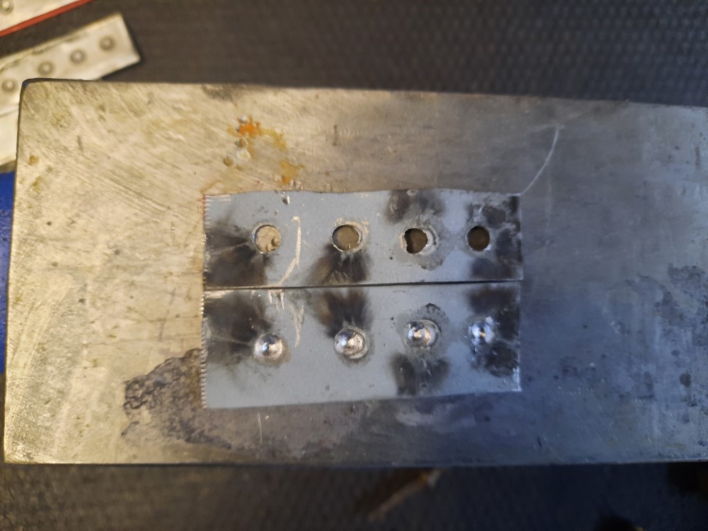

3) Frost Weld Thru Zinc Primer. Scorching here seemed less strong, with a very slight bit of browning around the spots as well.
4) Unpainted steel. This exhibits the same scorching patterns but instead of a black mark, if you look closely the molten metal is still there as a very very thin, shiny silver layer.
All together:
So closing thoughts on test 1 are that these are all potentially decent products to use as a weld through primer. They all welded perfectly strong spot welds, and as you can see, it's not like resistance welding burns off all the paint like MIG welding does. These spot welds might be on a wider piece of steel than the average sill or wheel arch lip, but I don't think it's fair to say all the primer will get burnt off. The pulse weld feature may limit or exacerbate any burn, I guess you could repeat this test without it.

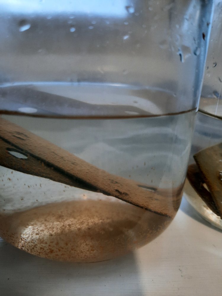

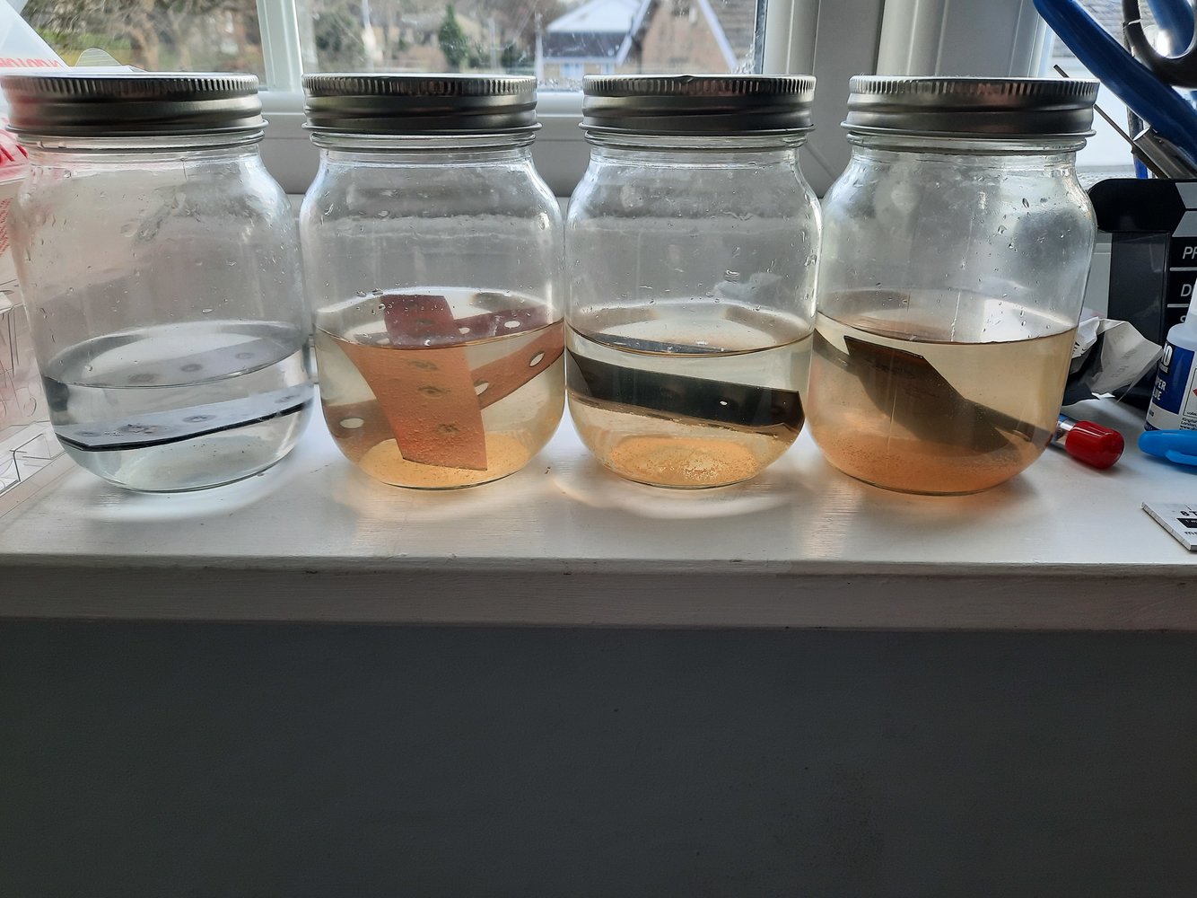

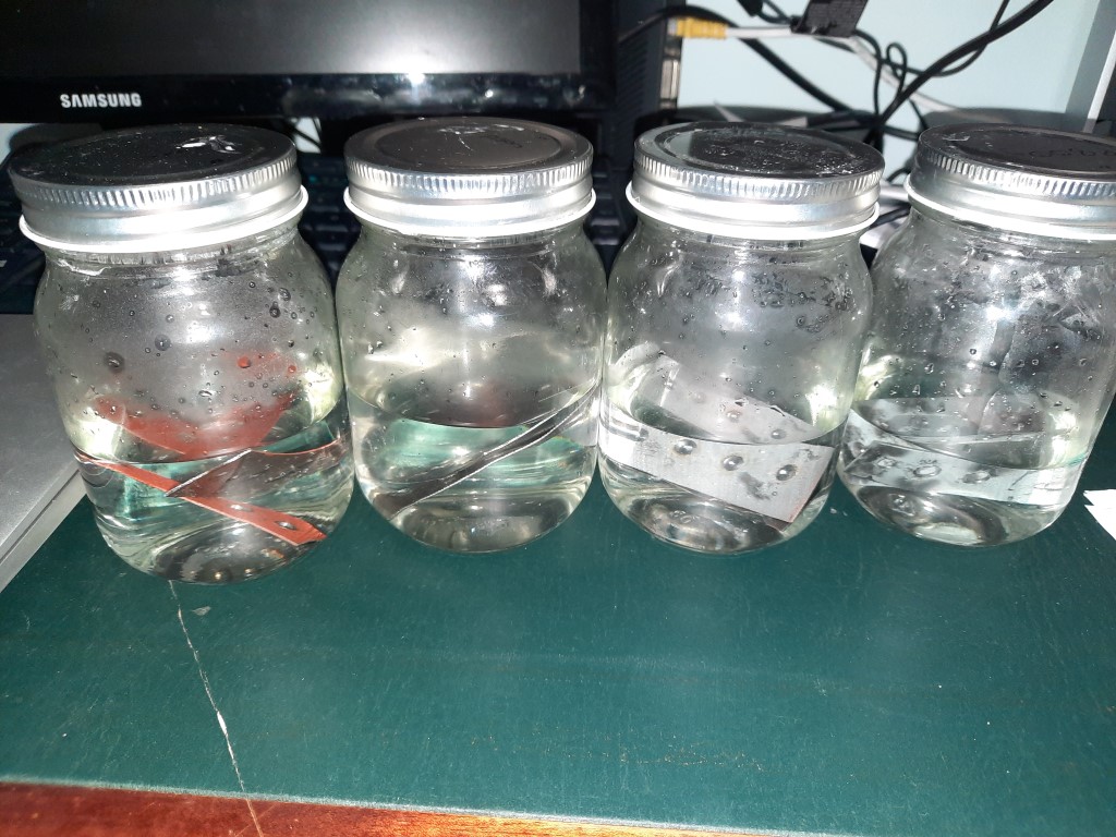

So onto test 2....
Interested to know your thoughts. Will test 2 work? Is it going to take me months to see any results, or could it be within days?
